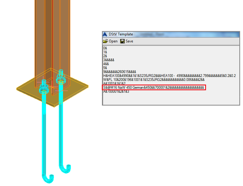

Anchor information within the model
Information about anchors is available in the DStV BOM. The anchor names have the "@" symbol placed in front of them and as an identification number they receive 70000 to be differentiated from bolts (that use 50000 and 60000).
To customize the displayed parameters, you need to access the Bolt category in the DStV BOM template.

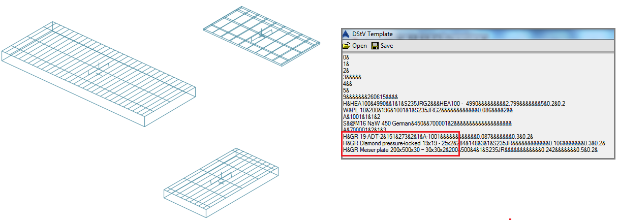

Grating names information
The name of a grating, as it appears in Advance Properties, can be displayed in DStV BOM lists.

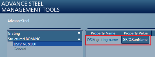

The default that controls this representation is called Dstv grating name and it is located in the Management Tools application. This default needs to use the %RunName parameter:
This DStV BOM configuration applies to all types of gratings (standard, bar and variable).
