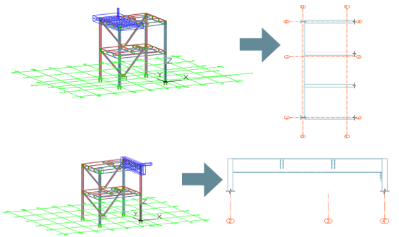

Detailed Grids in All Limited View GA Drawings
Grids that have this option checked can be detailed in limited view GA drawings, even when the grids are not actually included in the viewport. This applies to both plan and elevation details. When you create a new grid, this option is checked by default.
For example, if the grids that are placed in the model on the bottom level of the structure have this option checked, they will be visible in a camera drawing that details the top level of the structure. Using this option, you can detail the same grids in GA drawings that show different levels of the structure, no matter if the position of the grids in the model is above or below the viewport of the detail.
Note: The option is only available for horizontal grids, and it will be unavailable for grids created on planes that are not parallel to the world XoY plane. Non-horizontal grids cannot be detailed in GA drawings having viewports that do not include them. If you select several grids, including non-horizontal grids, you can check or uncheck the box for “Projected grid vertically for model view and drawings” for all the grids at the same time. In this case, a tooltip informs that only the horizontal grids in the selection will be affected by the change of the state of the option.

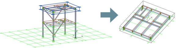

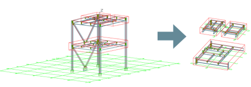

Projected Grids Model Views
Grids that have this option checked are visible in activated model views which include the grids and in model views that do not include the respective grids but are positioned above or below the model grids. When you create a new grid, this option is checked by default.
For example, if the grids that are placed in the model on the bottom level of the structure have this option checked, the respective grids will be visible in model views that do not include them but are positioned above them.
If more than one model view is activated at the same time, the grids that have the option checked will be visible in all the activated model views.
To prevent any unwanted modification done to the grids, you will not be able to modify the projected grids that are not actually enclosed in a model view. This includes modifying the grid properties, copying the grids, moving, or deleting the grids, even if the respective grids are visible and selectable in that activated model view.
Note: The option is only available for horizontal grids, and it will be unavailable for grids created on planes that are not parallel to the world XoY plane. Non-horizontal grids will not be visible in model views that do not actually include them. If you select several grids, including non-horizontal grids, you can check or uncheck the box for “Projected grid vertically for model view and drawings” for all the grids at the same time. In this case, a tooltip informs that only the horizontal grids in the selection will be affected by the change of the state of the option.
