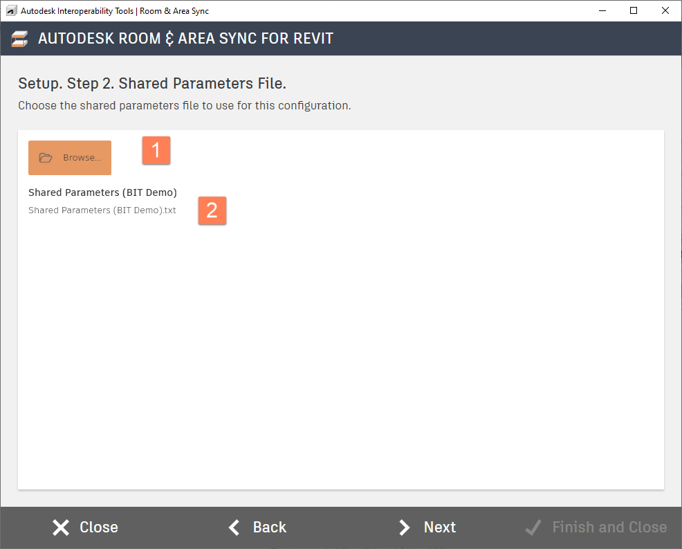

Step 2 identifies a Revit shared parameter file. In the next step, parameters from this file can be selected to add to Rooms and/or Areas.
  1. Browse... button to navigate to and select the shared parameter file.
  2. The currently selected shared parameter file. If Start From Scratch is selected in Step 1, this area will be empty until a file is selected.

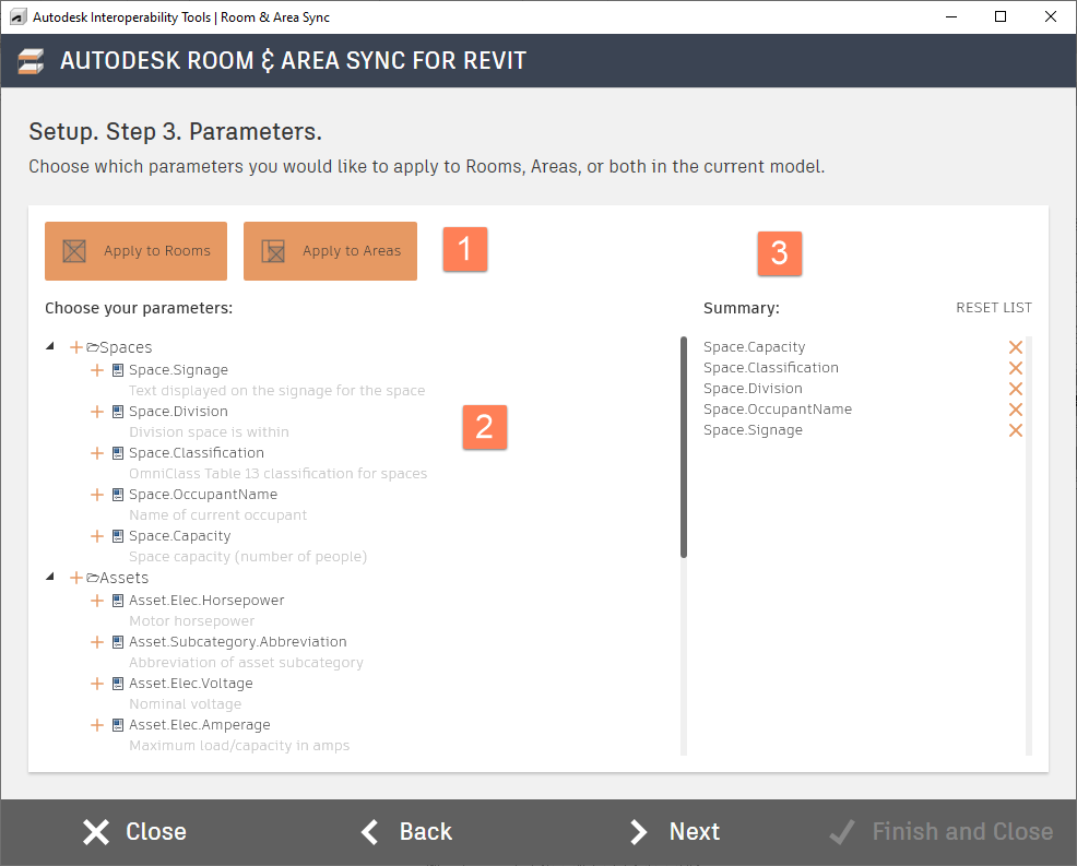

Step 3 identifies the parameters Setup will add to elements.
  1. Select if parameters will be added to Rooms and/or Areas
  2. The list of parameters found in the selected shared parameters file. The groups can be expanded or compressed. To select a parameter for inclusion, click the "+" next to it
  3. Parameters added from area 2 will be listed here. They can be removed individually by pressing the "X" next to them or the entire list can be cleared by clicking RESET LIST

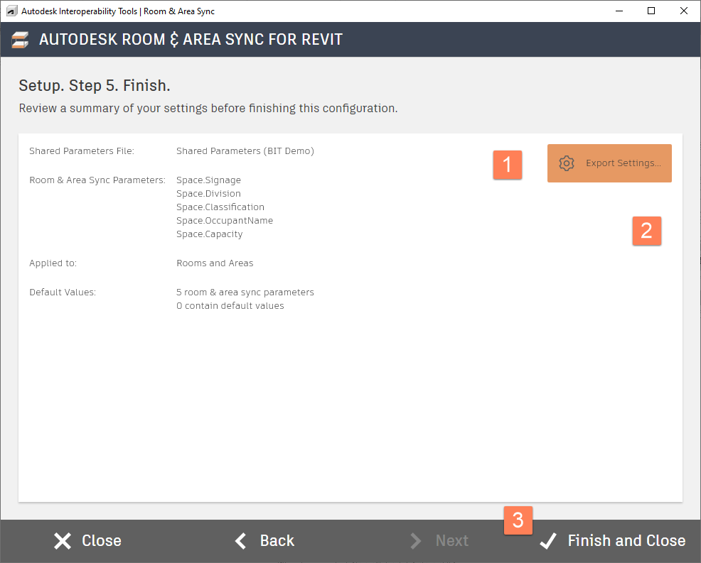

Step 5 provides a summary and a means to save the configuration for later use before running the tool.
  1. A summary of the settings
  2. Export Settings... will open a dialog box to save an XML file with the settings configured in the prior steps. Note that it does not save new copies of the shared parameter file or the Standardized Data Tool database. It is recommended to have copies of these in a defined location that the Room & Area Sync tool configuration is able to access if
