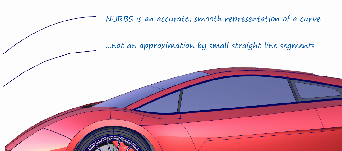

The key benefit of NURBS is that it isn't an approximation of a smooth shape. The math calculates an accurate definition of the surface shape which is still smooth however closely the surface is examined.
(Note: For speed of interaction, the smooth NURBS curves will be displayed as straight-line approximations on the screen, but the actual underlying math, and the resulting product that is manufactured from the data will be smooth.)

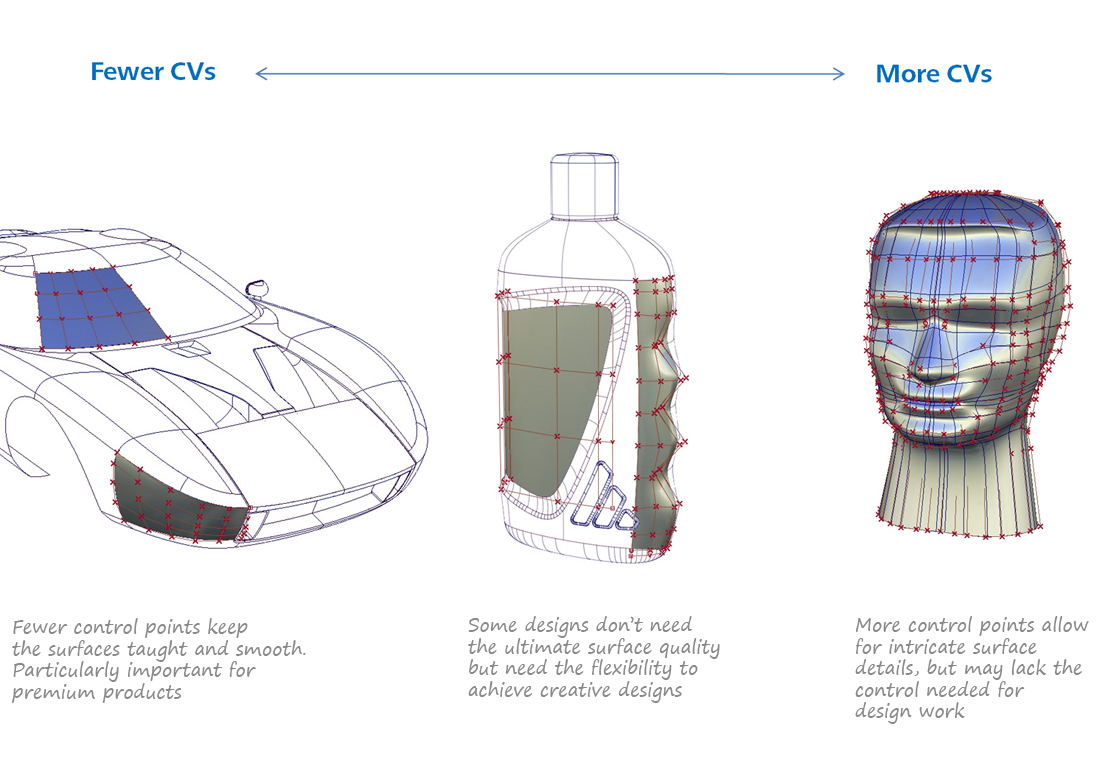

A NURBS surface is defined by a network of Control Points. The position of the control points 'pull' the surface patch into a shape, like a flexible sheet.
The key skill that you will develop is choosing the right number of control points, and the right position of each of them to achieve the sculpted surface shape that you need:

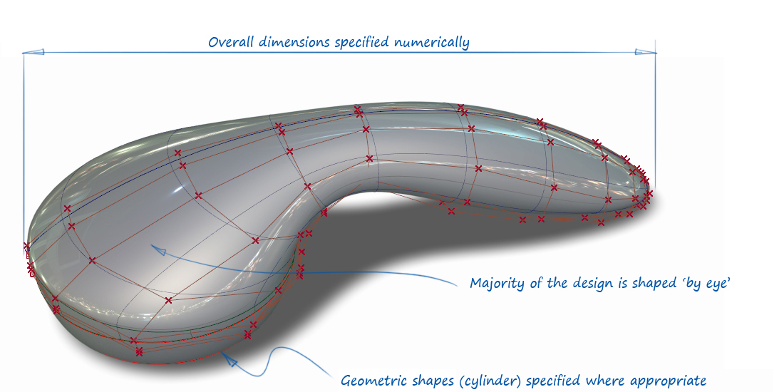

Alias NURBS allows the user to sculpt any shape, and is typically used for freeform, sculptural designs that can't be defined by dimensions or geometry.
  • Primary Interaction: aesthetic, artistic, sculptural choices of shape and form.
  • Secondary Interaction: geometric and dimensional criteria – arcs, ellipses, straight lines, angles.

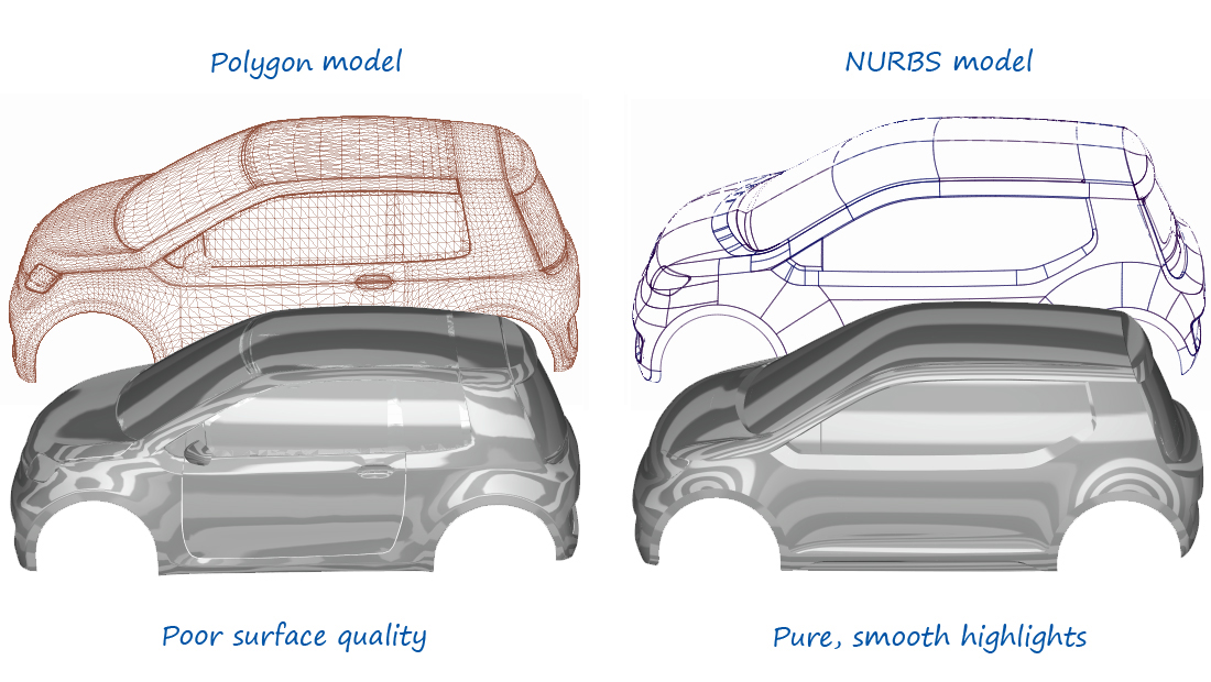

Polygon modeling is generally seen as easier to learn and easier to use than NURBS modeling, and because of this, it is beginning to be used more for concept design work.
Alias NURBS compared to Polygon Modeling
Polygon modeling is not used for production quality final designs because of the lack of surface smoothness.
A polygon model is a collection of flat facets that approximate a smooth shape. This is adequate for rendering or prototyping (and in fact NURBS models are converted to a polygon representation for these purposes), but not for production.
The CNC machine tools that create the tooling for final products work from the accurate, smooth NURBS data.

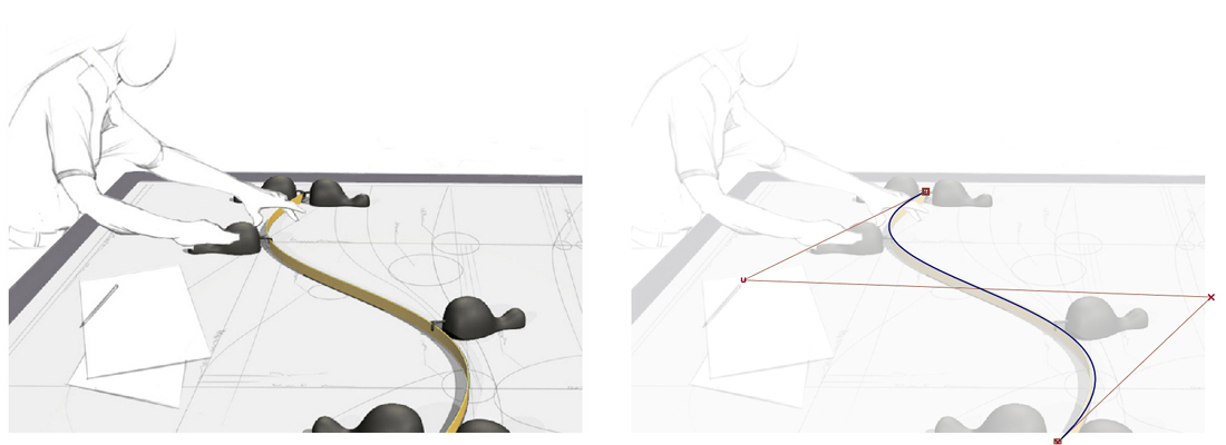

A useful way to understand how the NURBS geometry works (without needing to understand the math) is to compare it to the traditional way of creating large, smooth curves using physical splines:
Traditional Modeling
NURBS Modeling
Material
Long, thin pieces of wood, plastic or metal
Mathematics called NURBS – Non-Uniform Rational B-Splines
Controls
Heavy metal weights called 'ducks'
Control Vertices – CVs – also known as Control Points
Flexibility
Depends on the stiffness of the material
Depends on the Number of CVs, determined by the Degree and Spans
Smoothness
Created by the consistent density of the material
Determined by the Degree and Spans of the NURBS curve
Shape (1)
Position of the weights along the curve...
Position of the CVs along the curve...
Shape (2)
... and by the distance it pulls the curve away from flat
... and the distance of the CVs away from the curve
Controls connected by...
No connection
Lines called Hulls
