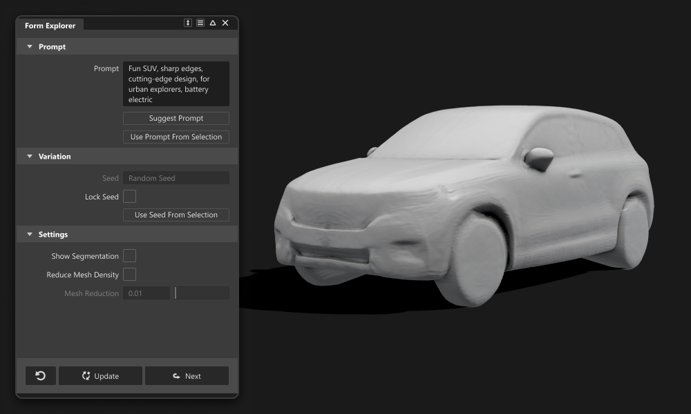

SUV Shape
Form Explorer Control window and a generated mesh of an SUV.
Example Prompt
Fun SUV, sharp edges, cutting-edge design, for urban explorers, battery electric
  • Keywords: fun, compact, urban, cutting-edge, agile, sleek, sharp, streamlined, dynamic, bold
  • Structure: Start with the car type (e.g., fun SUV), add the design characteristics (e.g. cutting-edge design, agile handling), and end with the context or audience (e.g. urban explorers).
