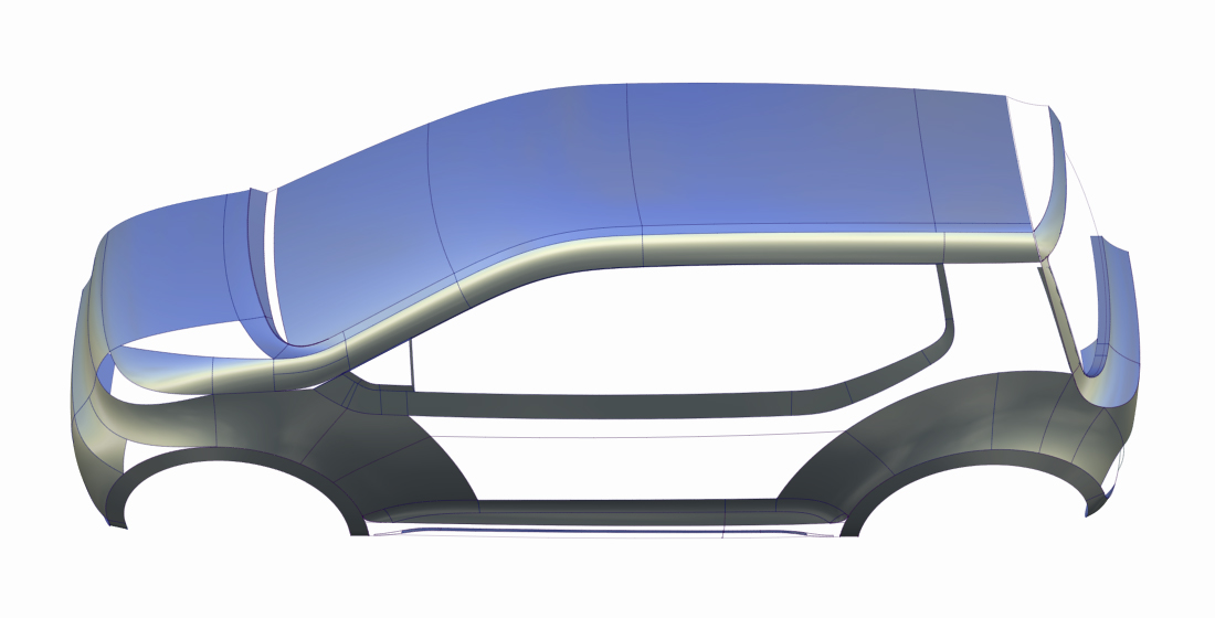

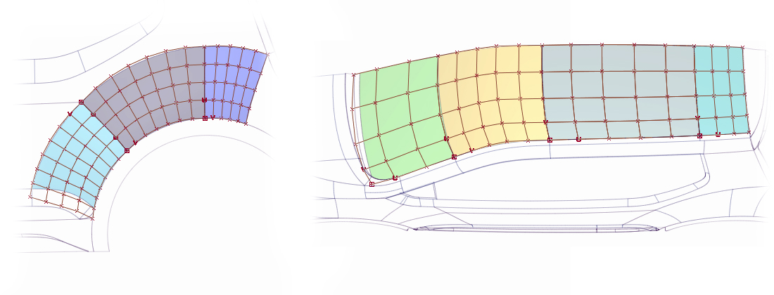

In this car example, the majority of the surface patches are 4-sided. It is often easiest to identify the obvious 4-sided regions and start modeling these first.

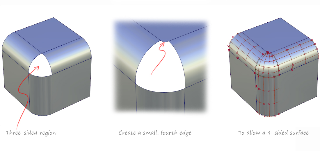

If a region isn't obviously four-sided, sometimes you can re-think a patch layout to allow for a 4-sided patch. Try to create a patch layout that allows the CV layout to flow naturally around the shapes you want. (If this isn't possible, it's usually better to use trimming instead – see below.)

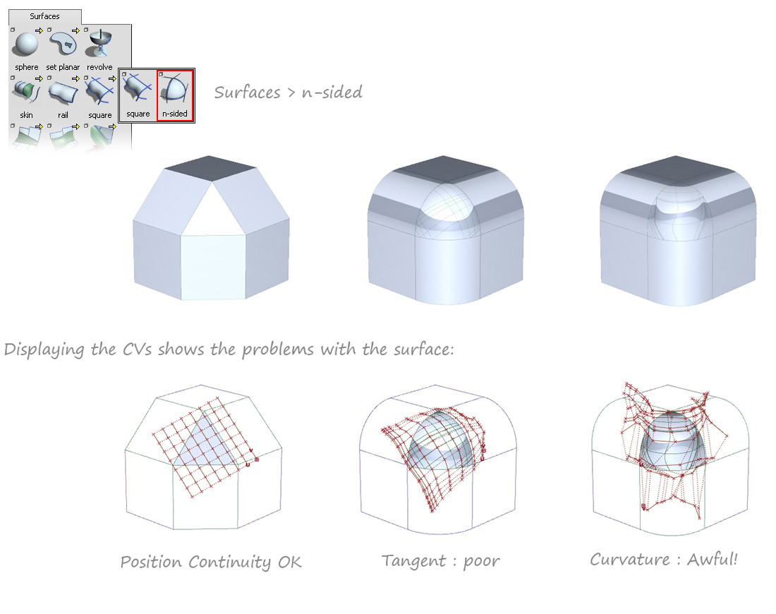

The 'good' way to break the rule is to use trimming to create the non-4-sided patches – see the next Golden Rule Trim to achieve n-sided surfaces.
A 'bad' way to break the rule is to use an n-sided surface to create a surface across any number of boundaries. It does this by building a 4-sided surface and then trimming it to shape.
The quality of the surface is typically poor (which is why it is 'bad'), but it can be used in concept design to quickly close a gap.

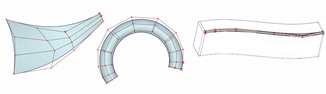

'Four-sided' refers to the topology rather than the shape, so a 4-sided surface patch doesn't have to be square or rectangular. As long as the CVs flow in the direction of the surface shape you want, then the four boundaries can describe a wide variety of shapes.

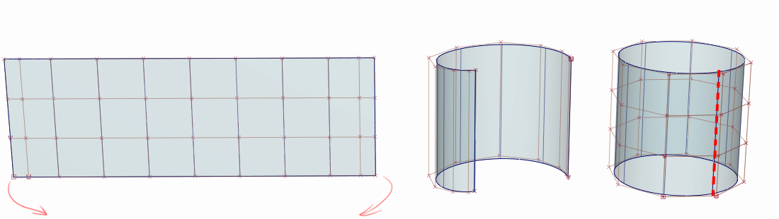

If a four sided surface is wrapped around so that two of the sides touch, for example a cylinder, the surface appears to have only two open edges at the top and bottom.
The cylinder can be open or periodic – see the Theory Builder Circles and Revolves for more information.
