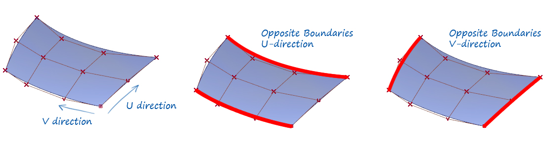

Surfaces have two directions, U and V. Each direction can have different degree and spans. So there are two 'pairs' of edges:

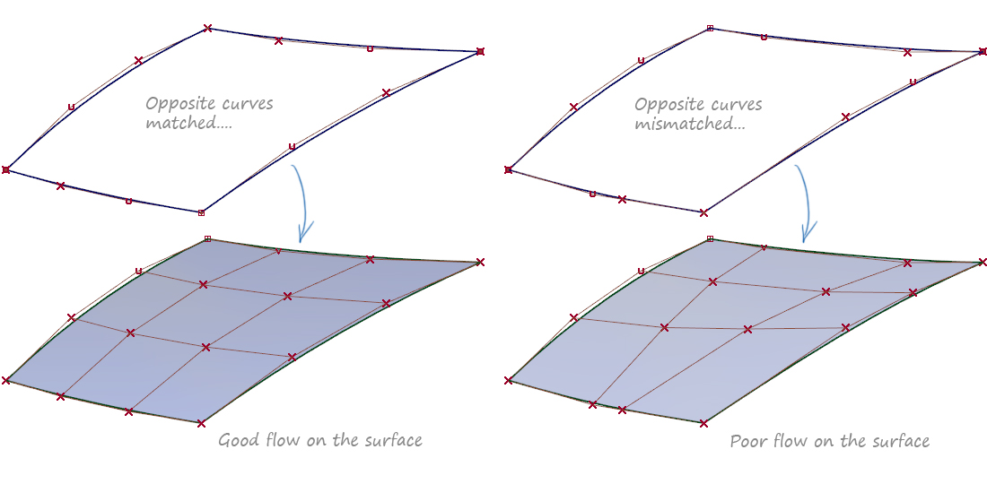

When creating curves for building new surfaces, if the parameterization of the pairs are matched, then the surface can be built with a good flow of CVs.
Applying the Rule

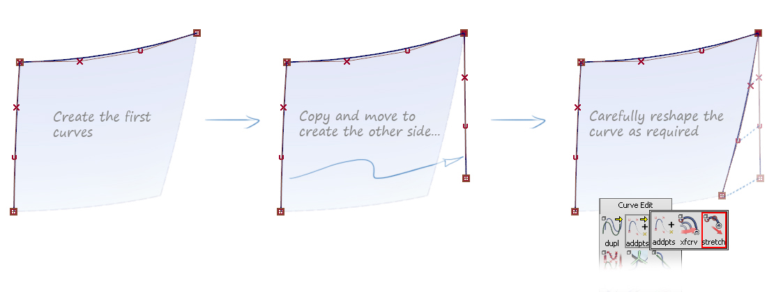

This rule applies when you are creating curves as boundaries for new surfaces. Try to get into the habit of copying a curve for the opposite side (to have the same parameterization) before moving CVs to reshape it.
The Curve Edit > Modify > Stretch tool is useful for reshaping the curve while keeping the same distribution of CVs.

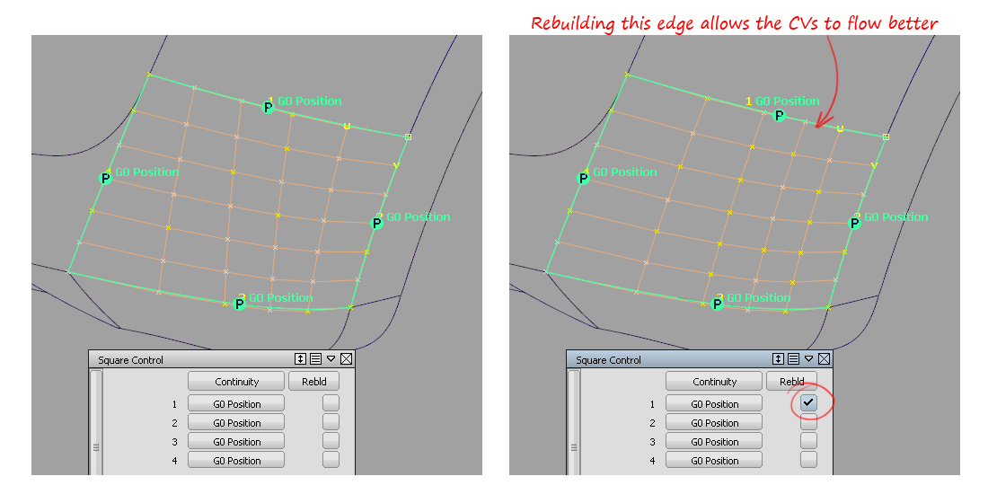

When you are building from existing surface edges for example, and don't have this option, the Rebuild option in the Square and Rail tool can be used.

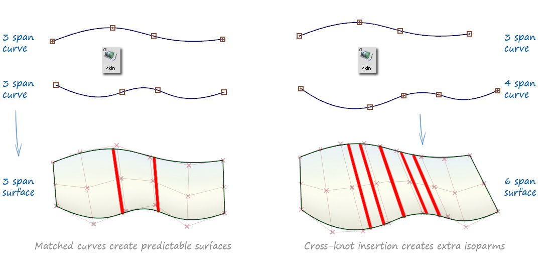

Multi-span Curves
The previous example was of single-span curves. Matching curves is even more important if you are working with multi-spans.
In this example, when there are the same number of edit points on both curves, they can be directly connected. When there are different number of edit points, extra isoparms have to be created. This is called 'cross-knot insertion'. (Another term for isoparm is 'knot'.)

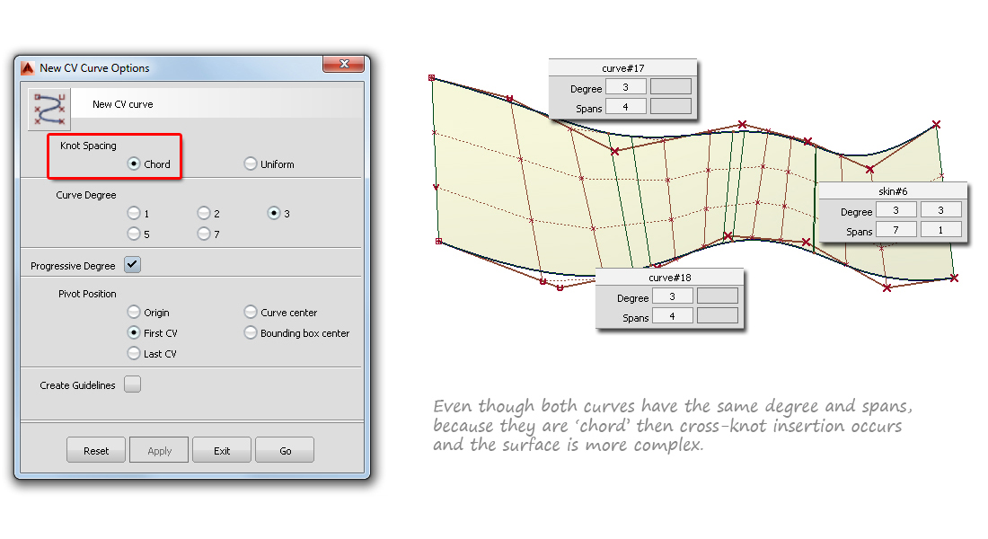

Chord and Uniform Parameterization
There are two settings for curves:
- Uniform – Edit points have integer parameters: (1, 2, 3....). This means that 1 matches to 1, 2 to 2, 3 to 3 etc., giving a predictable resulting surface.
- Chord – Edit points have chord-length values, which relate to the physical distance between the edit points. Typically these aren't matched, so extra isoparms have to be created for each unique value.
The examples above showed Uniform curves, which is the default setting and gives the best results.
With Chord you can get 'cross-knot' insertion where you get much more complex surfaces than you would expect. Chord is only used by very experienced users in specific situations, as it gives a slightly different shape to the curve.
