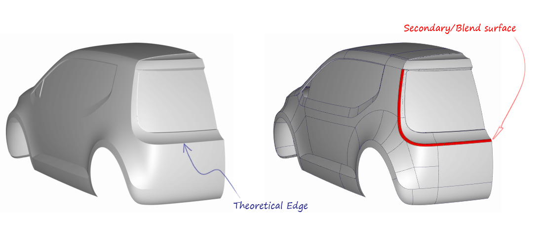

'Theoretical' simply means the sharp edge before a shape is filleted or softened.

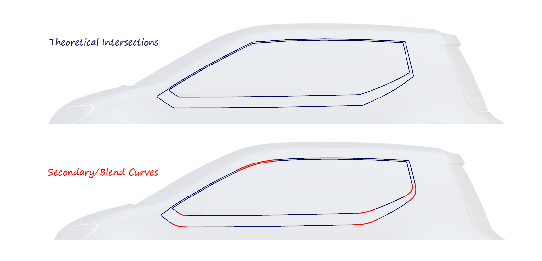

This example shows the outline curves for the side windows. They were first created to the 'theoretical' intersections, before the transitions were applied for the final design.
Experienced modelers start by building the Primary Surfaces to these sharp edges, or 'theoreticals', and try to build a block model with crisp edges, until the volumes are working aesthetically.

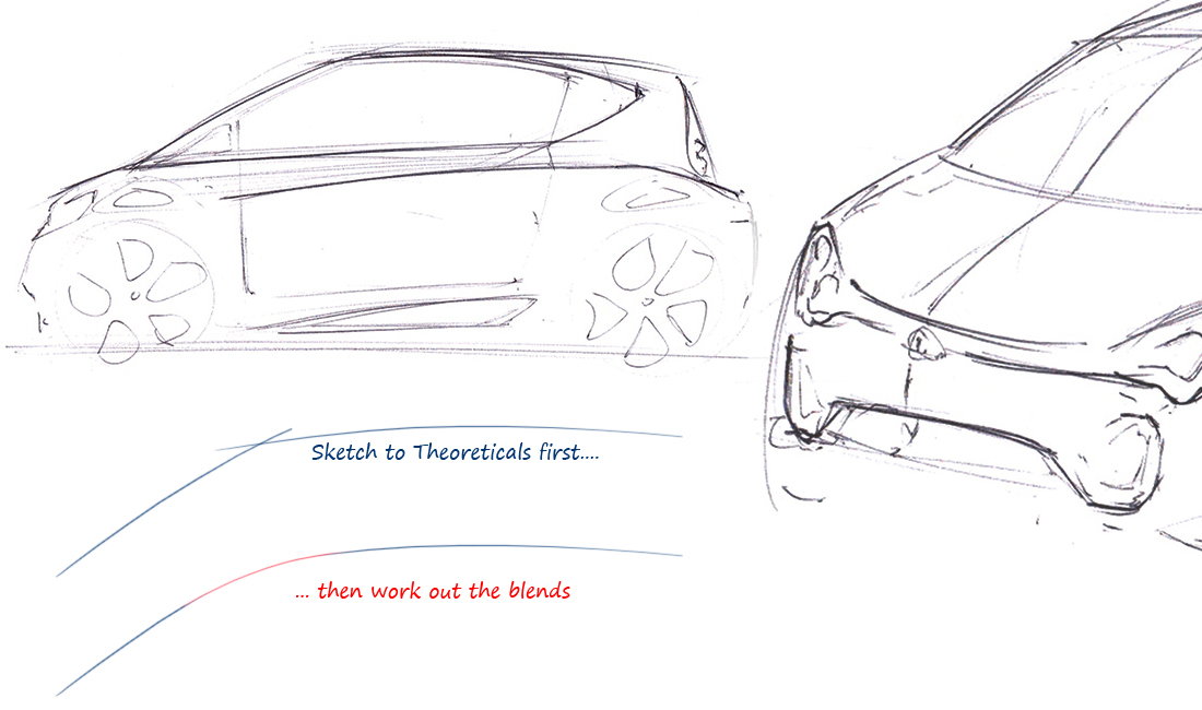

Working to theoreticals is a natural part of the sketching process. We do it to get a strong, taut line. If we tried to draw the main shapes and blends in one pencil stroke, the line would be less confident and have less tension. The same principle applies to building Alias curves and surfaces.

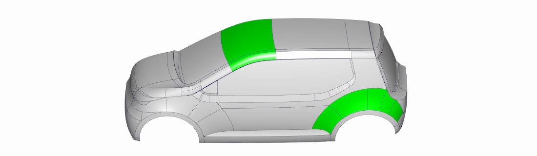

Breaking the Rule
It is common for some large blended shapes to be constructed as blends from the start, rather than strictly building to theoreticals first:

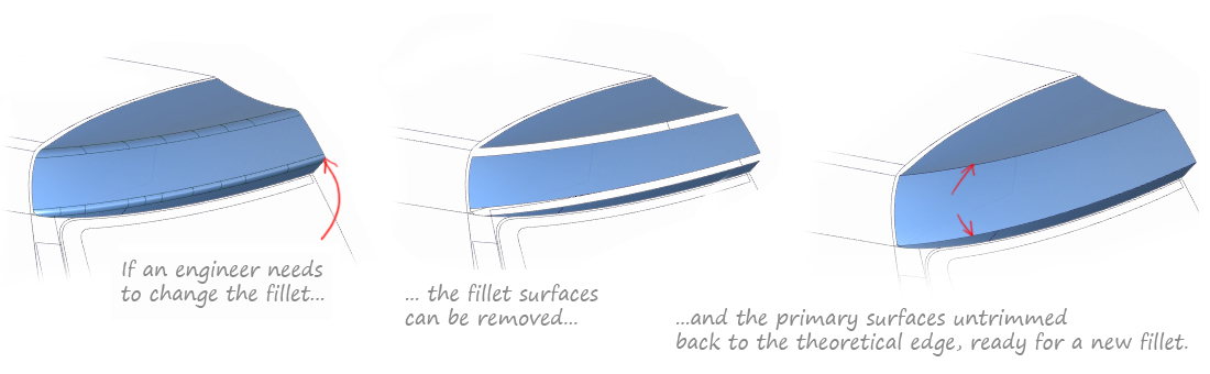

Theoreticals and Downstream Engineering
Working to theoreticals provides more flexibility to downstream process. In particular, if an engineer needs to modify a detail fillet, having the original theoretical edges allows them to make modifications.

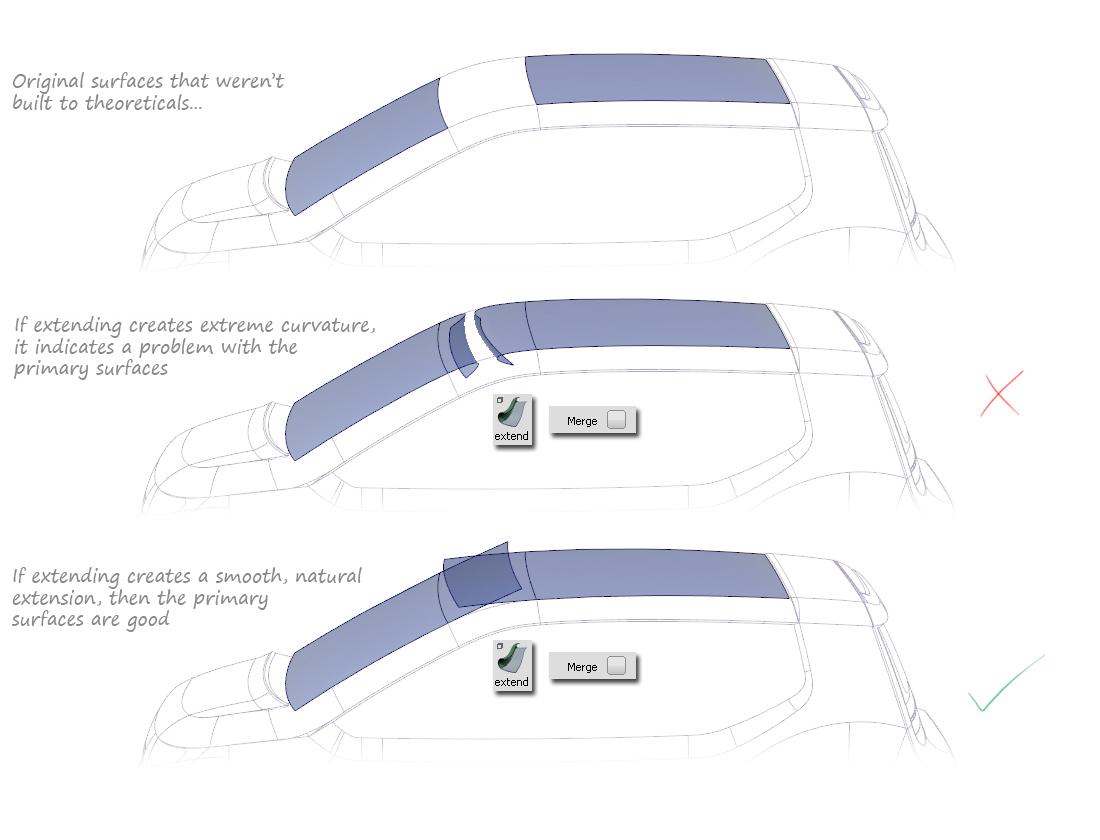

Extendable Surfaces
Extendable Surfaces are necessary to ensure usability in CAD-Modelers like CATIA V5. The process is hidden to the user, but Part Design in CATIA V5 automatically extends surfaces. If they can't extend successfully to create a theoretical intersection, then the process will fail.
You can check if your surfaces are extendible by using Object Edit > Extend.

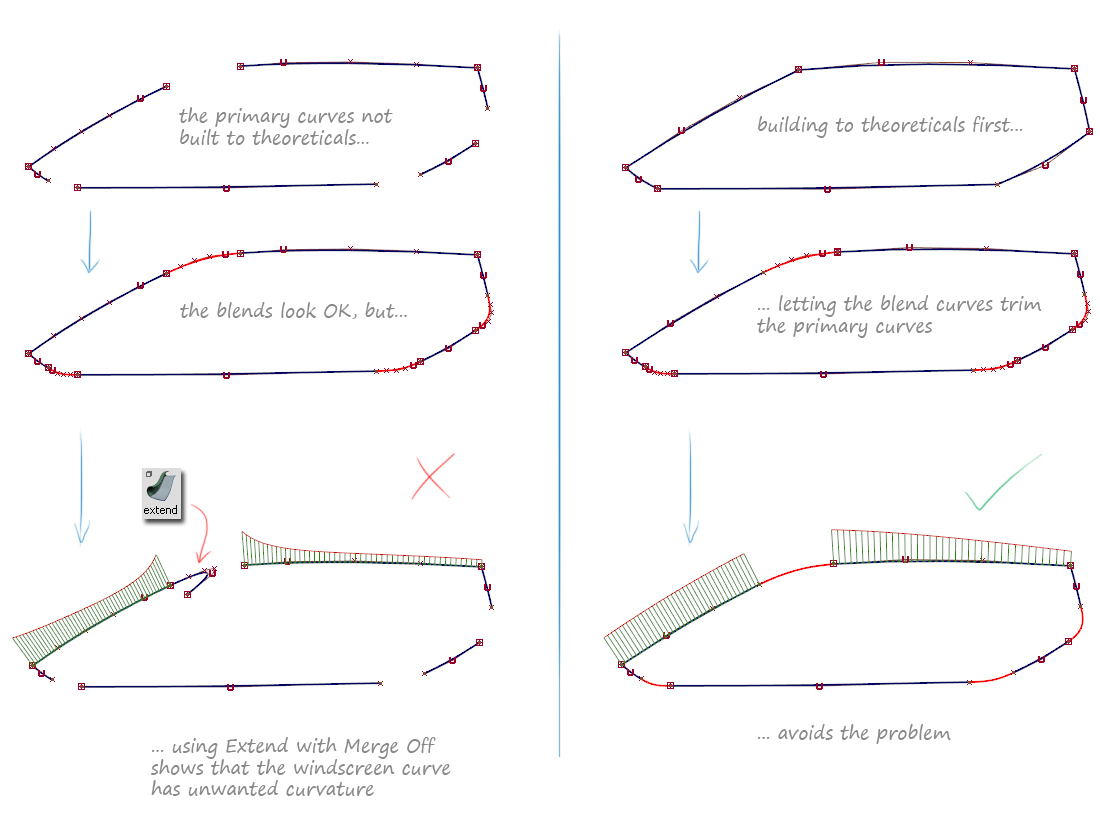

Problem Solving
You can often waste time by trying to fix fillets that don't work, without understanding that it is sometimes the underlying primary surfaces that are causing the problem. Removing the blends and checking that your primary surfaces extend to the desired intersections is a good troubleshooting technique.
Getting into the habit of building to theoretical intersections in the first place will avoid these problems.
