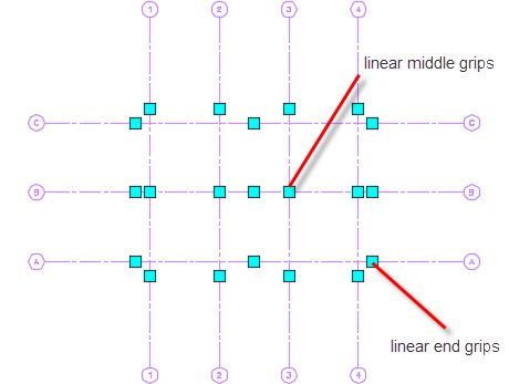

Editing Linear Enhanced Custom Column Grid with Grips
Edit with Linear Middle Grips
When you manipulate the linear middle grips, the following characteristics are maintained:
  • Movements of the middle grips are constrained and are limited to the direction perpendicular to the grid line being dragged.
Edit with Linear End Grips
When you manipulate the linear end grips, the following characteristics are maintained:
  • Movements of the end grips are not constrained and can be moved in any direction.
    Note: This may result in breaking the regularity of the linear grid line and changing the original geometry.
  • If you only shorten and lengthen the end grips without changing the direction, the regularity of the linear grid line is maintained.

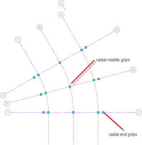

Editing Radial Enhanced Custom Column Grid s with Grips
Edit with Radial Middle Grips
When you manipulate the radial middle grips, the following characteristics are maintained:
    Note: This may result in breaking the regularity of the radial grid line and changing the original geometry.
  • The movement of the middle grip is constrained and limited to direction perpendicular to the tangent of the middle grip. Therefore, when you use the center of the radius as the origin, the radius of the grid arc changes.
  • Both sides of the arc fall along the path of the radial grid line.
  • It is not possible to drag the middle grip in such a way that the arc radius is less than zero.
Edit with Radial End Grips
When you manipulate the radial end grips, the following characteristics are maintained:
  • If you only shorten and lengthen the end grips without changing the direction, the regularity of the radial grid line is not broken.
When you add grips, stretch the middle grip, or extend the end grips within or beyond the first and last extension point, all endpoints of the intersecting grid lines closest to the first or last grid lines are adjusted accordingly.
