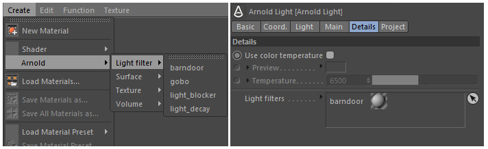

Creating Light Filters
Since light filters are shaders, to add a new light filter, you have to create a new Arnold Material. Go to the Material Manager and select Create > Arnold > Light filter from the menu. Then drag and drop the material to the light filter list.
