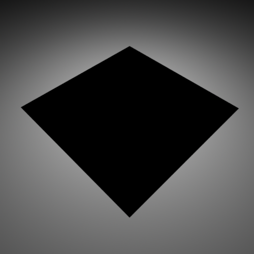

Geometry Type
Determines the shape of the blocked light. A light_blocker can be a box, cylinder, sphere, or plane.
box | cylinder |
sphere | plane |

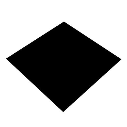

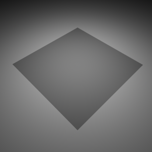

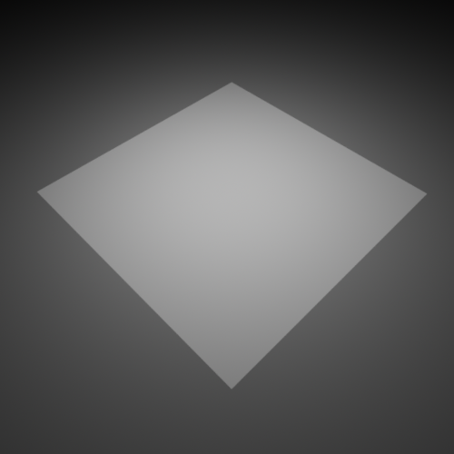

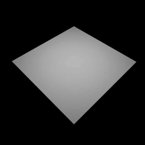

Density
This value is the strength of the light_blocker effect.
-1 | -0.5 | 0 (default | 0.5 | 1 |

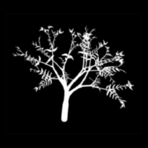

Shader
Plug the output of the shader you wish to use as a masking effect here. For example, a texture map used to represent the shadow of some tree leaves. Unlike gobos, you can position a shadow independently of the light transform. It works with all types of lights instead of just spot lights (unlike the gobo, which also contributes illumination to the scene). It only works when geometry_type is set to Box.
Tree mask connected to shader. Mask is static when light position changes.

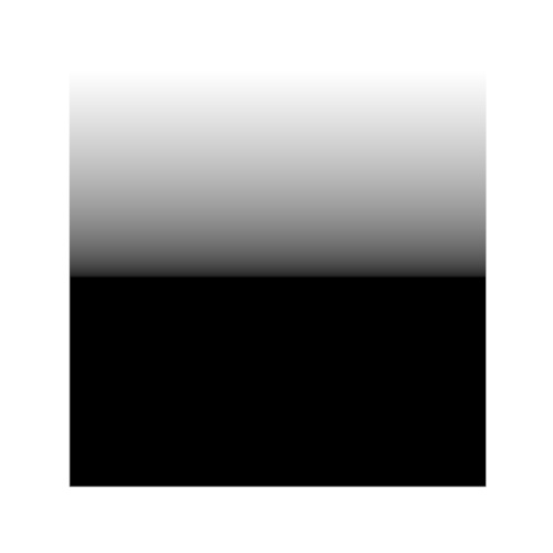

Axis
Attenuates the ramp based on the direction set.
x | y | z |

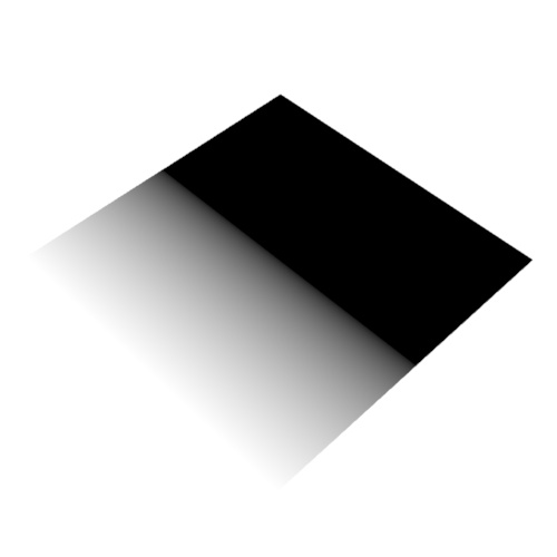

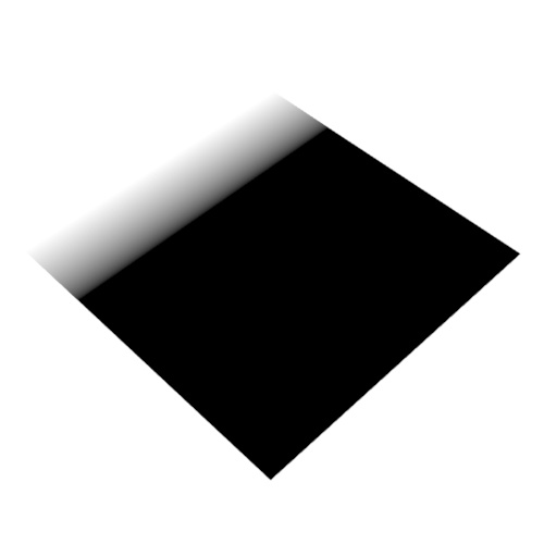

Ramp
This is the magnitude of the ramp multiplier, applying along the Ramp Axis direction. Negative values flip the ramp_axis direction.
0.25 | 0.5 | 0.75 |

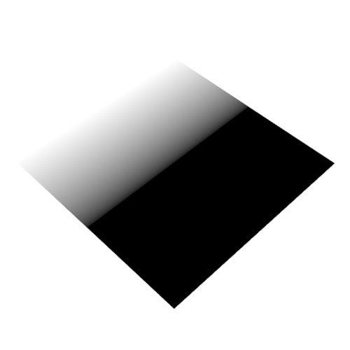

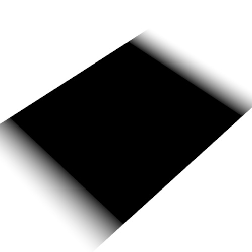

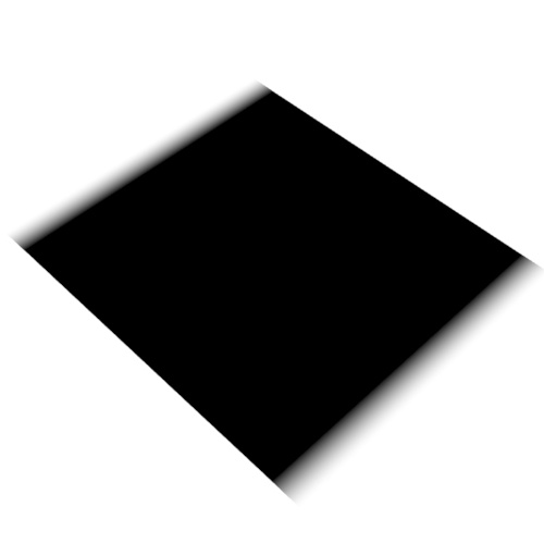

Height Edge
Attenuates the edge of the height of the light_blocker.
0.1 | 0.25 | 0.5 |

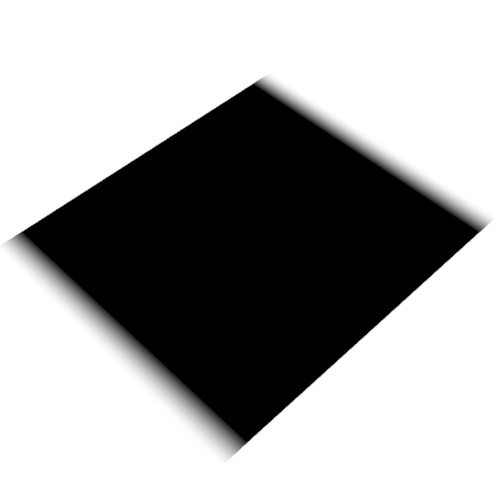

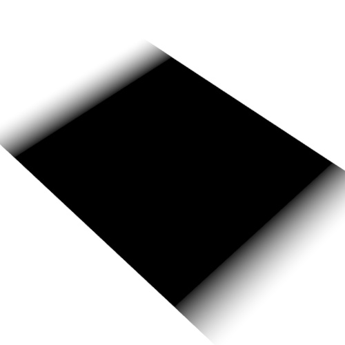

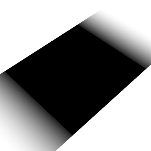

Width Edge
Attenuates the edge of the width of the light_blocker.
0.1 | 0.25 | 0.5 |

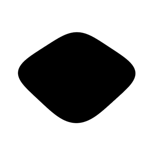

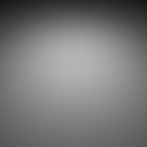

Roundness
Increases the circular shape of plane light blockers.
0 | 0.5 | 1 |
