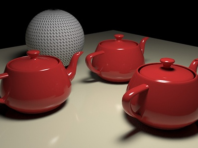

This short tutorial will cover how to use the Set Parameter, Collection, and Disable operators to change the lights and self-shadowing of some teapots and alter the shading of the sphere. The scene contains two lights casting shadows on three teapots and a sphere with a simple Utility shader assigned to it.

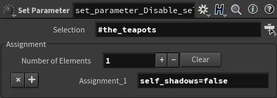

Set Parameter (Disable Self Shadows on the Teapots)
  • Create a Set Parameter. Create the following expression:
self_shadows=false
#the_teapots

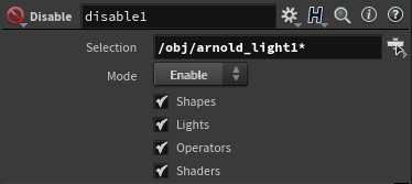

We can turn off one of the lights by using the Disable operator.
  • Create a Disable operator and under Selection enter for the following Arnold light:
/obj/arnold_light1*
ArnoldLight001 disabled

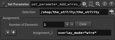

Set Parameter: Sphere Utility Shader
Now we will change the Overlay Mode for the spheres Utility shader.
  • Assign a Utility shader to the sphere and rename it to the_utility.
  • Create another Set Parameter and under Expression enter the following:
overlay_mode="wire"
  • Under Selection enter the following:
/shop/the_utility/the_utility
Utility shader altered with Set Parameter
Final Operator Graph output
