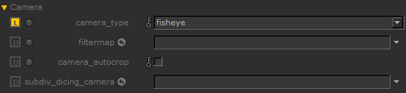

Fisheye Camera
This camera node provides a fish-eye lens-type view. The depth of field and aperture controls are similar to those of the standard perspective camera, but the fisheye camera also provides control over the field of view.

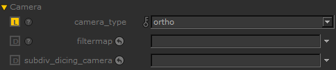

Orthographic Camera
The Arnold orthographic camera node has no attributes since it merely creates an orthographic view based on the current viewport.

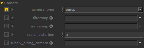

Perspective Camera
This camera node provides a perspective view, like a regular camera. This is the 'standard' camera type that you will probably use most often. In addition to a normal perspective, this camera type also provides controls for the depth of field and the focal length of the camera, as well as controls related to the aperture of the camera. This allows various camera lens effects, including bokeh, to be simulated.

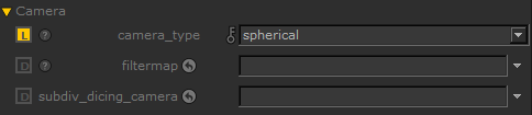

Spherical Camera
This is a spherical camera, which means that the camera lens has a spherical appearance. A common use of this camera projection is to allow the creation of environment maps (in spherical map format) for later use as reflection maps or for environment lighting. To get the full spherical range, the camera's screen window must be set to [-1,-1] to [1,1]. Note that the same mapping could be achieved in the cylindrical camera with careful setting of the Horizontal FOV, Vertical FOV, and Projective parameters, but the spherical camera is provided for convenience.

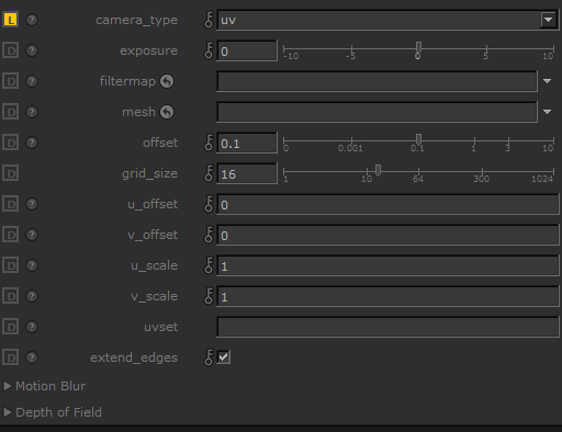

UV Camera
uv_camera allows rendering an image in a mesh UV space. It can be used to bake a specific rendering and apply it later using an image node.

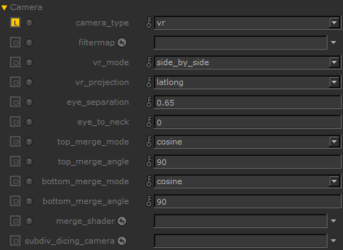

VR Camera
This is a generic VR camera implementation. It features two cameras offset by a distance with a specific 360º projection.
