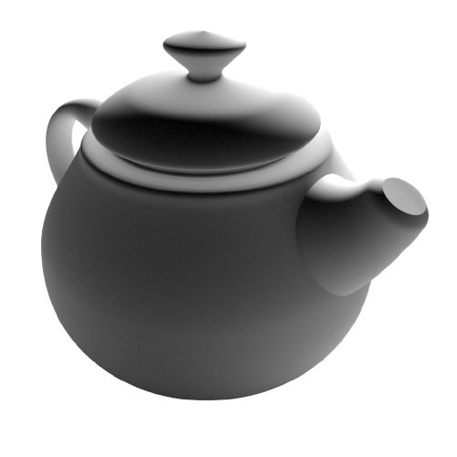

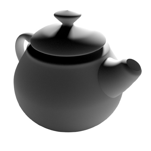

self_shadows
Determines whether or not the object casts shadows on itself.
| Disabled | Enabled |

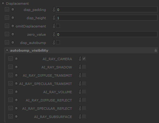

Displacement
Displacement maps can be an excellent tool for adding surface detail that would take far too long using regular modeling methods.
omitDisplacement
Displacement will be ignored.
