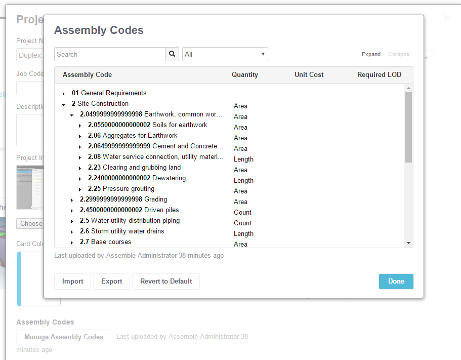

After importing a custom assembly code file into the Project Settings, you may find codes that have numerical values that appear incorrect.
Simply formatting the numbers in Excel as something like "Text" leaves those numbers as numbers in the underlying data, and that is what we see in Assemble on import (and then rounding badness, etc). Excel doesn't do a very good job exposing that this is the case.
