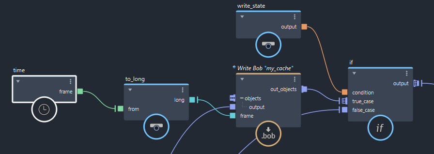

Writing files using batch execution
Batch execution lets you write out cache and other files without the risk of accidentally overwriting them. This process uses the write_state global variable, which is managed by Bifrost and set to true during batch execution.
It requires some preparation in your graph:
  • If you are using file_cache nodes, set their mode to the new Write State Mode.
  • If you are using write_* nodes, use if nodes to execute them only when the output of write_state is true.
save files to disk when write_state is true

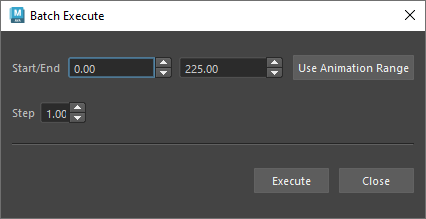

To write files using batch execution:
  1. Choose Edit > Batch Execute.
  2. Specify the time range.
  3. Click Execute. The write_state global variable is temporarily set to true while the files are being written.
specify the time range for batch execution
You can cancel batch execution in progress by choosing Edit > Cancel Batch Execute.
