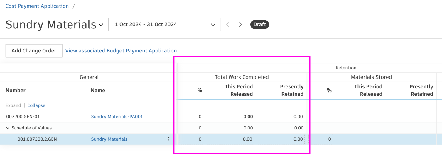

Note: To set a payment application as final, the values visible in the Balance and Total Work Completed sections should be 0.
Retention values 0

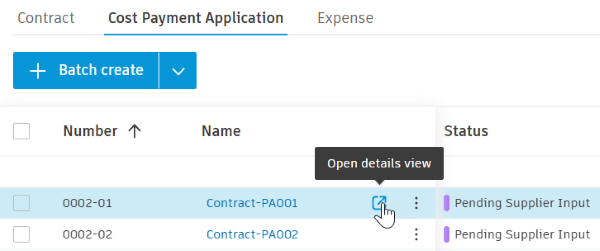

  1. Go to the Cost tab, then switch to the Cost Payment Application tab.
  2. Open the details of the Cost Payment Application you wish to set as final.

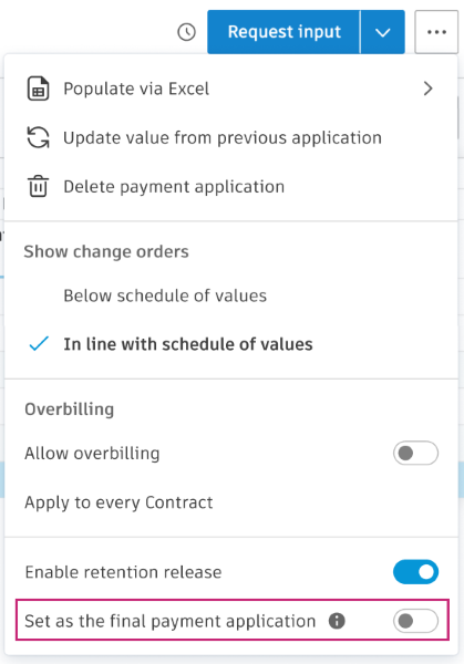

  3. In the payment application details, open the More More menu button menu.
  4. Toggle the switch for Set as the final payment application.

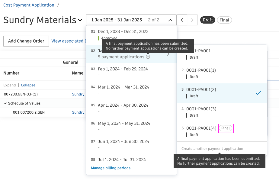

Application is now set as final and new cost payment applications can't be created.
Tooltips show when application is marked as final
Marking a payment application as final will trigger the release of all retained funds associated with the contract. Ensure that all work is completed and inspected before setting the payment application as final.
