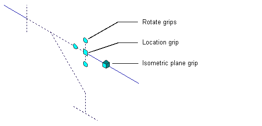

Isometric schematic symbols have 2 types of rotation grips:
  • Rotate grips: Use these grips to rotate a symbol in its current isometric plane (isoplane).
  • Isometric plane grips: Use these grips to rotate a symbol around the 3 isoplanes: left, top, and right.
Note: Because schematic symbols are attached to schematic lines using curve anchors, you can also rotate symbols using the Curve Anchor commands on the context menu.
