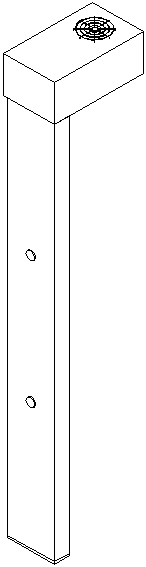

The following example shows a simple duct systems on separate floors connected to a vertical trunk in a reference drawing.

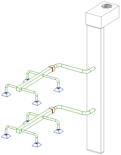

This example shows takeoffs that are added to connect with the duct systems on each floor in the referenced drawing.
