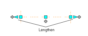

- Lengthen grips (
) change the length of a part segment. Lengthen grips use the segment's current orientation to maintain connectivity in the existing run.

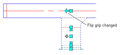

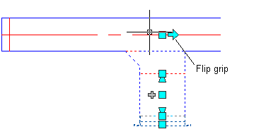

- Flip grips (
) switch the orientation of some parts (such as fittings or takeoffs) based on the direction of the grip.
Takeoff selected — Flip grip shown
Orientation flipped
