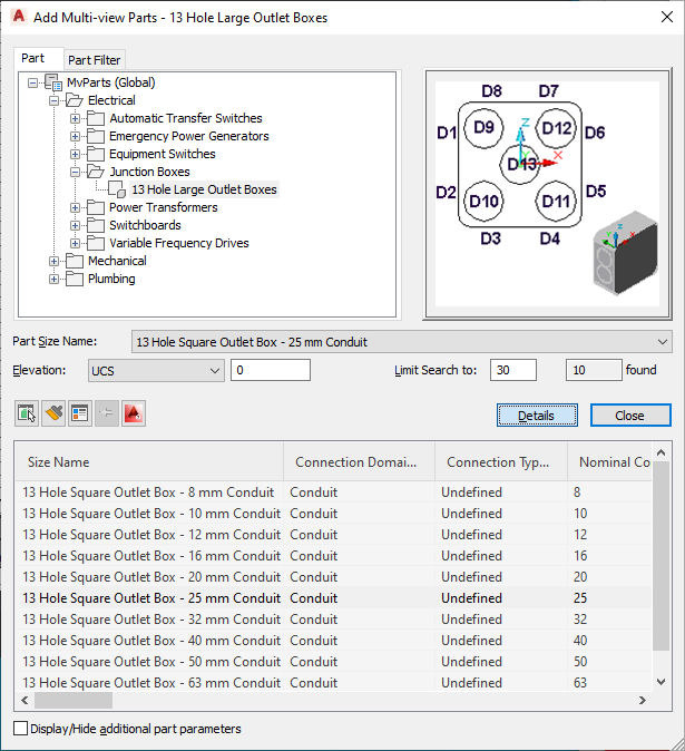

You can browse part catalogs through the Add and Modify dialogs, which give you direct access to the parts currently available to integrate into your designs. When you select a part from a part catalog, you are selecting a specific part size that is defined in a part family.
In the Add Multi-view Parts dialog box and Multi-view Part Modify dialog box, you can also use the Part Filter tab to specify part properties to query a part family to find a specific part size. You can view the part sizes available in a part family by clicking Details. The available part sizes are presented in an easy-to-navigate part size table. Select Display/Hide additional parameters to show all the parameters in the table.
Note: The Visible attribute is initially set in the Parameters Configuration view in the Size Parameters dialog box in Content Builder.
