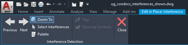

With a drawing open, click Analyze tab Inquiry panel Interference Detection . On the Interference Detection palette, click to start the analysis. When the analysis is completed, locate the Edit in Place tab on the ribbon to view the Interference Detection panel.
Use the information in the following table to help you view and resolve each interference:

move between the interferences in the list view and in the drawing click the Previous Interference and Next Interference buttons on the Interference Detection panel
automatically zoom to one or more interferences click Zoom To on the Interference Detection panel to toggle zoom mode, and then select one or more interferences in the drawing
