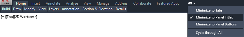

To display the ribbon if it is not displayed in your workspace, or has been turned off, enter ribbon on the command line.
You can use the
button at the right of the tab names to modify the appearance of the ribbon as follows:
- To display only the panel titles of the ribbon tabs, click
(Minimize to Panel Titles) at the top right of the ribbon.
- To display only the tab names as titles, click
again (Minimize to Tabs). - To display the full ribbon again, click
a third time (Show Full Ribbon).
