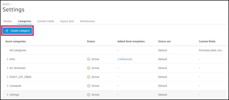

  1. Get started by clicking the Settings icon at the top-right to display Categories.
  2. Click Create category.

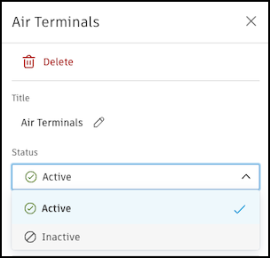

Set Asset Categories to Active or Inactive
All categories are set to active by default. When a category is inactive, users will no longer be able to assign assets to it. To change a category's status, select the category in the Categories tab in Settings and in the right panel that appears, select either "Active" or "Inactive".
If an existing asset is assigned to an "Inactive" category, its category will still be visible when viewing the asset details.

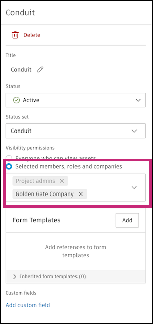

Asset Category Permissions
By default, project administrators and everyone who has been given access to the Assets tool can view all the assets in every category.
However, if you have assets that should be accessed by only a limited number of people, you can modify the permissions on asset categories. These allow only certain members, roles, or companies to see assets in specific categories in your project.
To edit the permissions on asset categories:
  1. In the Categories tab in Settings, click the category.
    Note: You can only edit the visibility permissions on the top-level category.
  2. In the right panel that appears, select Selected members, roles, and companies.
  3. Click the field and select members, roles, and companies from the drop-down menu.
Category permissions
An icon appears next to any categories in the list that have modified permissions.
Category permissions icon
