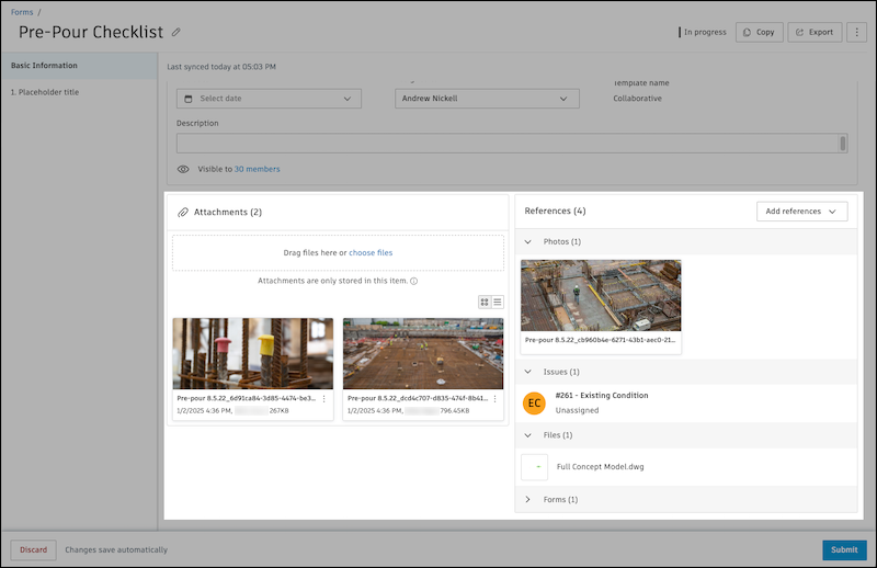

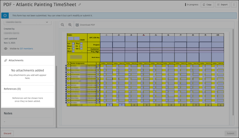

Key Differences Between Form Attachments and References
At the form level, you will see Attachments and References side by side.
  • Forms created in Autodesk Build
  • PDF forms
At the question level on forms created in Autodesk Build, you will see an option to add Attachments and adding Photos or Issues will create a reference.
Form references allow you to add and connect ACC project items that are related to a form. References can also be files, photos, or videos. The following table can help you understand the key differences between attachments and references:

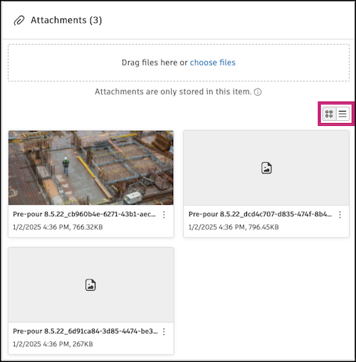

At the form level
  1. Open the relevant form.
  2. Navigate to the Attachments section in the Basic Information section.
  3. Add relevant attachments:
    • Drag desired files into the upload area
    • Browse your computer to select single or multiple files
    • Copy or grab a screenshot and paste it into the Attachments area
Note: A maximum of 100 attachments can be attached to a single form.

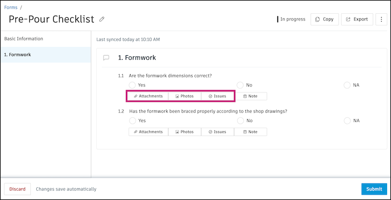

  1. Within a form, navigate to the relevant section and question.
  2. Click Attachments.
  3. By default, the option to browse your computer to select single or multiple files. Click Cancel if you want to use one of the following options instead:
Note: A maximum of 100 attachments can be attached to a single question.
In the Attachments section, you can then view your attachments in a thumbnail or list view by selecting each icon respectively. The attachments will only be viewable here.

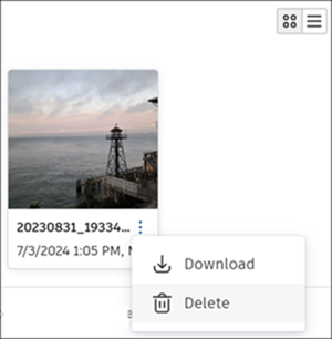

Download Attachments
Note: You can only download individual attachments at a time and only within each form or question separately.
  1. Navigate to the Attachments section in a form or under a specific question.
  2. Follow these steps depending on your view:
    • In the thumbnail view :
      • Click the More menu in the bottom right corner of the attachment that you want to download, and then click Download.
    • In the list view :
      • Click the Download icon on the right of the image.

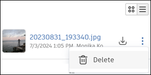

Delete Attachments
Editors and Managers on forms that are In progress can delete attachments at the form and question levels.
      • Click the More menu in the bottom right corner of the attachment that you want to delete, and then click Delete.
      • Click the More menu on the right of the image, and then click Delete.
