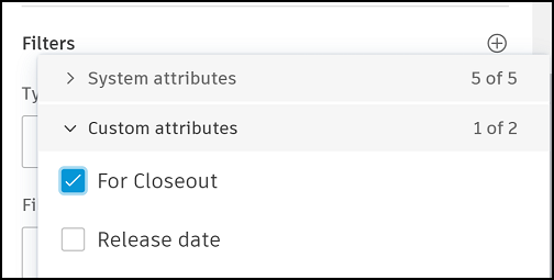

Filters
By default, the following default system attributes are available as filters:
  • Types: Filter by file or folder.
  • File types: Filter by filename extension. For example, PDF.
  • Version added by: Filter by members who added the current file version.
  • File statuses: Filter by locked files.
  • Current versions: Filter by current version number.
  • Last updated: Filter by a date range.
  • Review status: Filter by review status. Select (Empty) to include files with no review status.
You can also use any of the custom attributes you added in the search and filter settings.
  1. Click the + icon to the right of Filters.
Deselect any of the system attributes to hide them from the filter area. Select any custom attributes to use them as filters.
