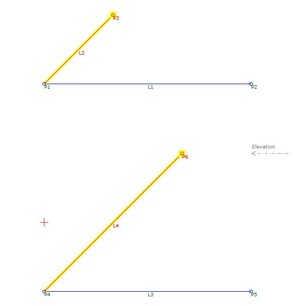

Examples
To see examples of how this geometry element is used, open the following Sample PKT file:
Point Angle and Delta Y.pkt
The example PKT contains two Angle and Delta Y point examples. Each Point Geometry Type is defined by Angle and Delta Y parameter values, and the Delta Y value may be overridden by a specified elevation target parameter. The same Delta Y value is used in both examples. The Static Delta Y (P1 to P3) example applies the value, but the Elevation Target example uses an elevation target parameter that overrides the static Delta Y value.
In the Flowchart, each example is constructed in a separate sequence. To review the parameters, select the Angle and Delta Y point in the appropriate sequence, and then see the Point Geometry Properties section of the Properties panel.
