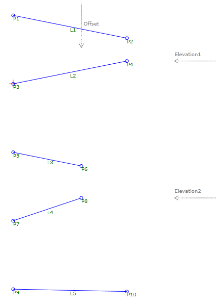

Examples
To see examples of how this geometry element is used, open the following Sample PKT file:
Point Slope and Delta X Example.pkt
The example PKT contains five Slope and Delta X point examples. Each Point Geometry Type is defined by Slope and Delta X parameter values, either of which may be overridden by specified target parameters. The same Slope and Delta X values are used in all five examples. The Static Values (P1 to P2) example applies the values, but the remaining examples use target parameters that override the static values.
In the Flowchart, each example is constructed in a separate sequence. To review the parameters, select the Slope and Delta X point in the appropriate sequence, and then see the Point Geometry Properties section of the Properties panel.
