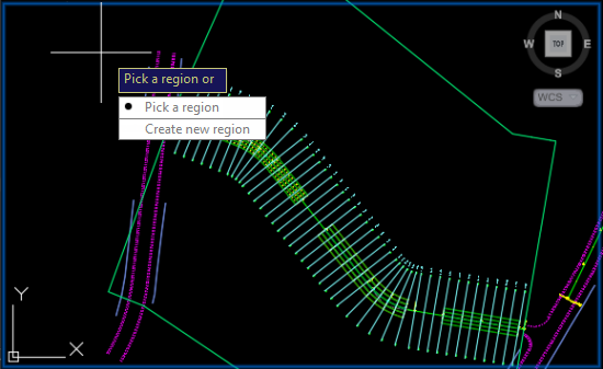

  3. Click the plan view viewport. The Select a corridor region options will be displayed.
  4. Select an existing rehab region in the corridor or add a new rehab region to the corridor.
    To select an existing rehab region in the corridor:
    • Click Pick A Region.
    • Hover over an existing rehab corridor region.
    • The rehab corridor region will be highlighted yellow.
    • Click to select it.
