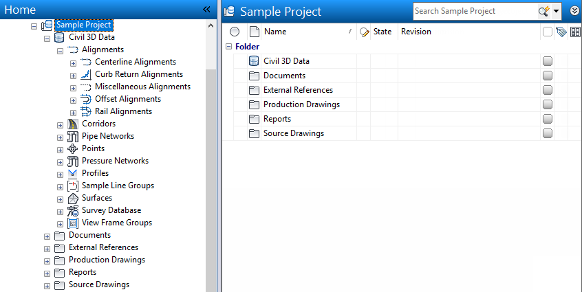

Autodesk Vault provides a stand-alone application that you can use to manage project files and users. The Autodesk Vault client window, shown in figure 10, uses a table to show project files and data about these files.
Figure 10: Autodesk Vault window
In the tool window, you can see all project files, including system files.
The window also lists all drawings where the selected file is used as a reference and displays DWF™ versions of the drawing files, so you can quickly find the version you need.
