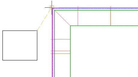

Use the Set Corridor Baseline Elevation by Reference command to set the elevation of a point on a feature-line based corridor at a given slope/grade from a specified location. This command adjusts the elevation of the corresponding PI on the corridor baseline accordingly.
You can use this command to specify the elevation of a point on a corridor in relation to an adjacent object in the drawing. The baseline of the corridor to adjust must be a feature line.
After starting the command, select a reference point to define the start point of a slope or grade, select a point on the corridor, and then specify the grade or slope between the two points. The point on the corridor is adjusted and the PI on the feature line that is closest to the selected point on the corridor is updated.

  3. Select the reference point to use. For example, this can be a point on an object that is adjacent to the corridor you want to adjust.
    The elevation of the selected point is displayed at the command line.
  4. Select the point on the corridor to adjust.
    • An object snap is required to select a point on the corridor.
    • The point must be on a corridor feature line.
    • The corridor must have a feature line as its baseline.
    • If there is not a PI on the corridor baseline near the location you select, you will be prompted to add one.
    • The top-most code at the selected location is used to calculate the grade or slope, even if you select a lower point in a 3D view.
