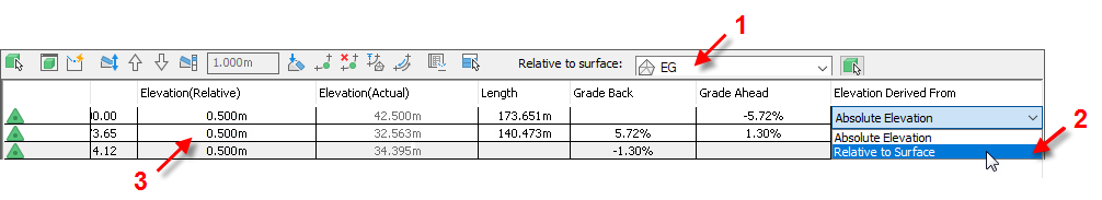

Feature line elevations that are relative to a surface
Feature lines can obtain their elevations from a surface and remain relative to that surface, or their elevations can be absolute.
You can specify relative elevation options by using the following features in the Grading Elevation Editor.
