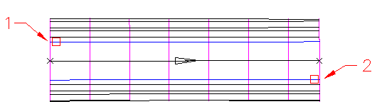

- Optionally, use the Boundaries tab of the Corridor Properties dialog box to create corridor boundaries that correspond to the areas on the corridor that you want to render with a specific material. You create the boundaries by selecting corridor feature lines that form the boundaries of the area. You should select the bottom end of one feature line followed by the top end of its pair.
For example, select the bottom outside edge of the lane followed by the top outside edge of the lane to create a boundary that encompasses both lanes:
