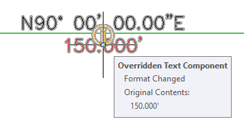

  • Format Changed: Indicates that the format of the label has changed, but the contents have not changed. In the following illustration, the color of the distance label was changed to red.

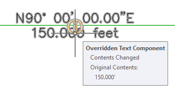

  • Contents Changed: Indicates that either the contents of the label have changed, or the contents and the format have changed. In the following illustration, the foot symbol (') was changed to feet.
