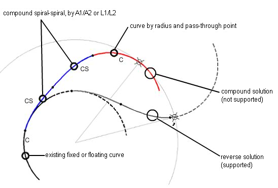

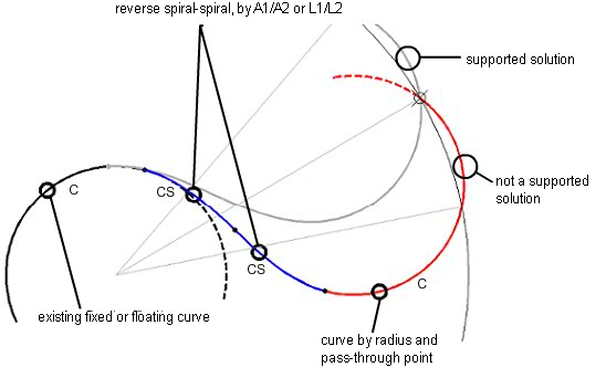

This entity does not support either of the following solutions:
  • Solutions that require a floating curve angle greater than 180 degrees. The following illustration shows both the supported and unsupported solutions:
  • Compound solutions. The following illustration shows an unsupported compound solution:
