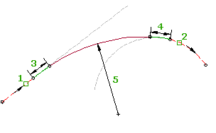

The type of spirals created (simple vs. compound) depends on the types of entities you attach it to. When the attachment entities (1, 2) are edited, the spiral lengths (3, 4) and curve radius (5) do not change. The attachment points and the curve length adjust to accommodate edits to the attachment entities.
