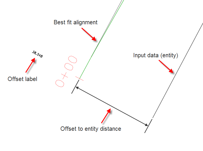

Label Offsets
Creates labels in the drawing that show the Offset to Entity information that is displayed in the Best Fit Alignment Report vista.
The labels show the positive or negative horizontal offset distance from the best fit alignment to the input data (entities). A positive value indicates that the input data is on the right of the best fit alignment (when starting at station 0+00), and a negative value indicates that the input data is on the left of the best fit alignment.
Note: These labels use the Standard text style at a height of 1.00, and they are created on layer 0.
