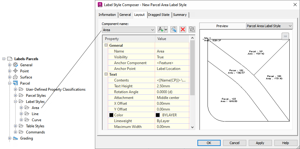

Label styles can include text, blocks, lines, ticks, and leaders. You can preview their appearance in the Label Style Composer dialog box, as shown in the following illustration:
Previewing customized label style for parcel area
