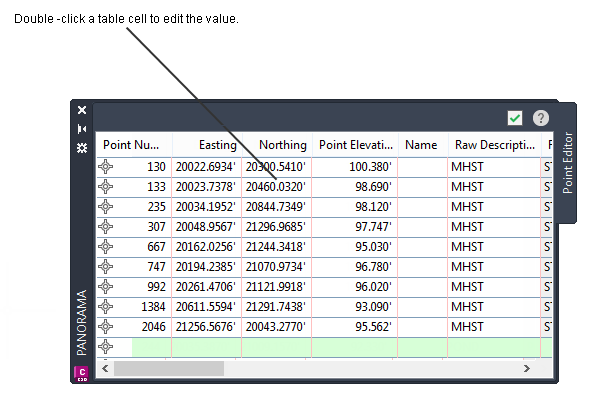

Panorama Window
Some object types, such as alignments and profiles, use the Panorama window to display a table of entities that make up that object.
The Panorama window is a floating, dockable window that you can keep open as you work. It can include several tables, called vistas, on different tabs. Panorama data shown in black text can be edited; data shown in gray text cannot be edited.
Panorama window showing an alignment

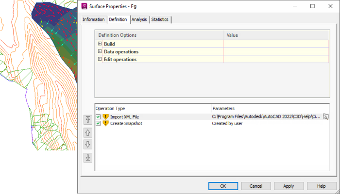

Property Editors
When you right-click any object on the Prospector tab, and then click , you can view all the Autodesk Civil 3D properties of that object, and edit some of them.
These properties typically include the styles, labels, related objects, and some structural details of the current object.
Properties editor showing surface properties

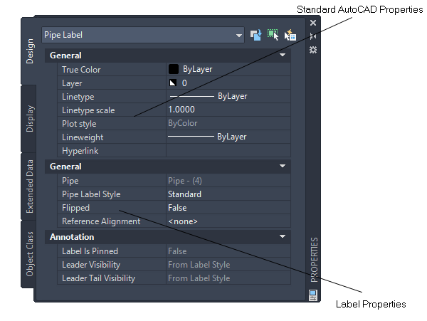

AutoCAD Properties Editor
When you right-click an object in the drawing, and then click , the AutoCAD Properties dialog box is displayed.
You can use this dialog box to review and edit AutoCAD properties, such as the layer on which the object is drawn. You can view the style assigned to the object, and can also change it here. You can also edit an object style on the Settings tab of Toolspace. Right-click the object style. Click Edit to open the <feature> Style dialog box.
Editing AutoCAD properties for a pipe label
