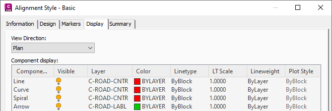

Object Component Layers
You specify component layers on the Display tab of the <object> Style dialog box. The following example shows layers used for alignment components:
The component layers allow you to work with objects as if parts of them are located on different layers.
Objects are physically created on the base layer, but the display of components is governed by the associated component layers. Each object component uses the visibility settings for the component layer (such as on/off), as well as the color, linetype, lineweight, and plot style for the layer if the various Component Display settings are set to ByLayer.
Note: Layer 0 has a special meaning in the Component Display settings. When the layer is set to 0, the object base layer is used for that component. For example, if the alignment base layer is C-ROAD, and the layer for the Line component is set to 0, then the alignment lines behave as if they are located on layer C-ROAD (not layer 0).
