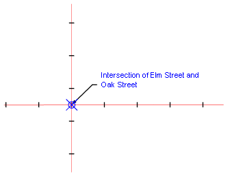

- If you want to reference objects in the drawing, create a Referenced Text component for each object you want to reference.
For example, you can create a note label with two Referenced Text components, each which refers to an alignment name. You can then insert that label at the intersection of two alignments, and select the intersecting alignments as the object data.
Click to view a station intersection label created with two Referenced Text components
