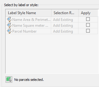

The following illustration shows the Selection section of the Add Table dialog box:
To add all labels of a particular label style name to a table, select the Apply check box next to the label style name. When you use this method, all the labels are switched to tag mode, and a child style is not created.
To add selected labels of a particular style to a table, click and click the labels. When you select a label in the drawing that is not in Tag display mode, a dialog box is displayed informing you that the label is not currently in tag mode and asking whether you want to create a new child style.
Click Yes to continue (if you click No a child style is not created and the label is not added to the table). Clicking Yes creates a child style of the current label style in the format <style name>.Tag.1.
