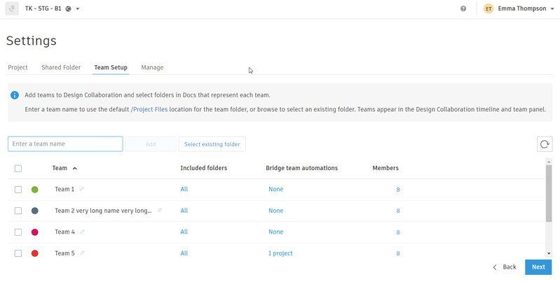

  2. Open the Settings tool > Team Setup tab:
  3. In the Bridge team automations column, click in the row of the corresponding team you want to create the automation for.

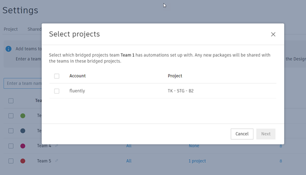

  4. In the Select projects dialog, choose the bridged projects that you want to set up the automation with. The dialog displays the account and project names to help you identify the correct project:
  5. Click Next.

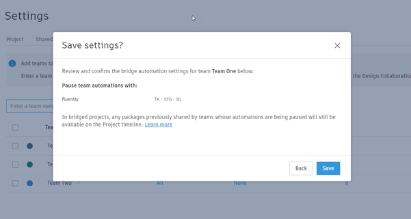

  5. On the Save settings dialog, check that the details are correct:
  6. Click Save.
