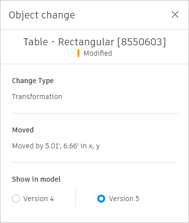

View Change Information
In the Change visualization interface, click an item in the Changes list to open the change details in the right panel.
At the bottom of the panel, use the buttons to toggle between the selected versions, and visualize the change in the model.
Click the Close icon
to close the panel.

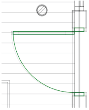

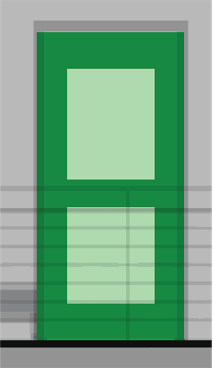

Added
| 3D | 2D |

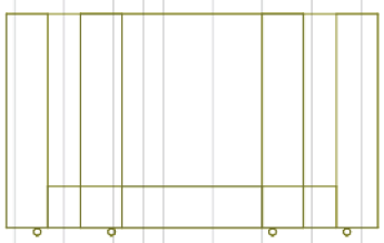

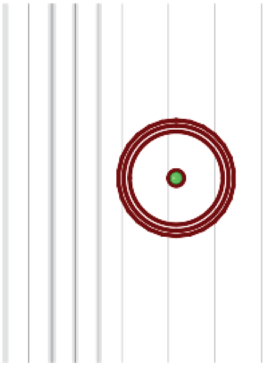

Modified
| 3D | 2D |

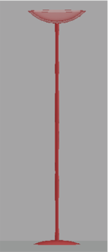

Deleted
| 3D | 2D |
