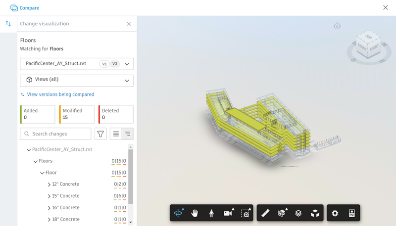

  9. If there are changes for the items you added to the watch group, the changes are displayed in a tree structure in the Changes list:
    Note: There may be no changes to view, for example if your team has not consumed the latest package containing a new model version, or if your work-in-progress model hasn't been shared, or is the same version as the shared model. In this case, the Change visualization interface is not displayed.
  10. Use the search box and filters in the Change visualization interface to refine the changes shown in the Changes list.
  11. Click a change in the tree to display more information about the change in the right panel:
    1. At the bottom of the panel, use the buttons to toggle between the selected versions, and visualize the change in the model.
    2. Click the Close icon to close the panel.
  12. Click the Close icon to close the viewer.
