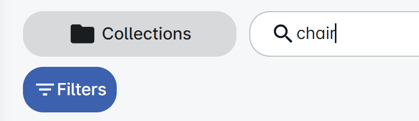

Step 2: Type in what you are looking for.
Standard Search

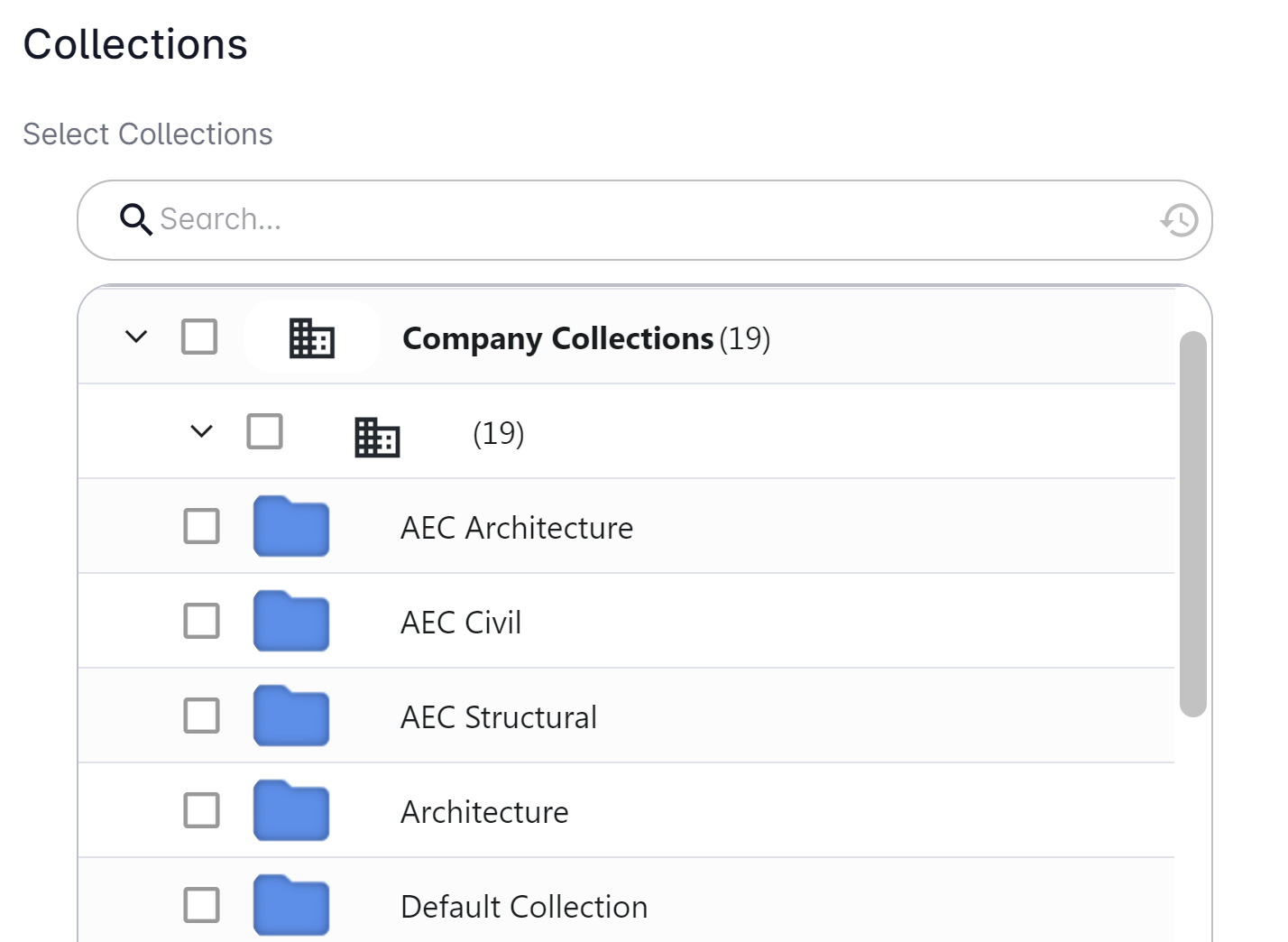

Step 3: To the left of the search bar, you will see the Collection you are searching. In the example below, All Collections is selected.
To change that selection and search a specific Collection, simply click on the Collections button to select a specific Collection or channel.

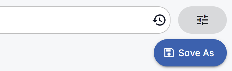

To specify the field you want to search, select the button with the slider icon to the right of the search field.
Standard Search

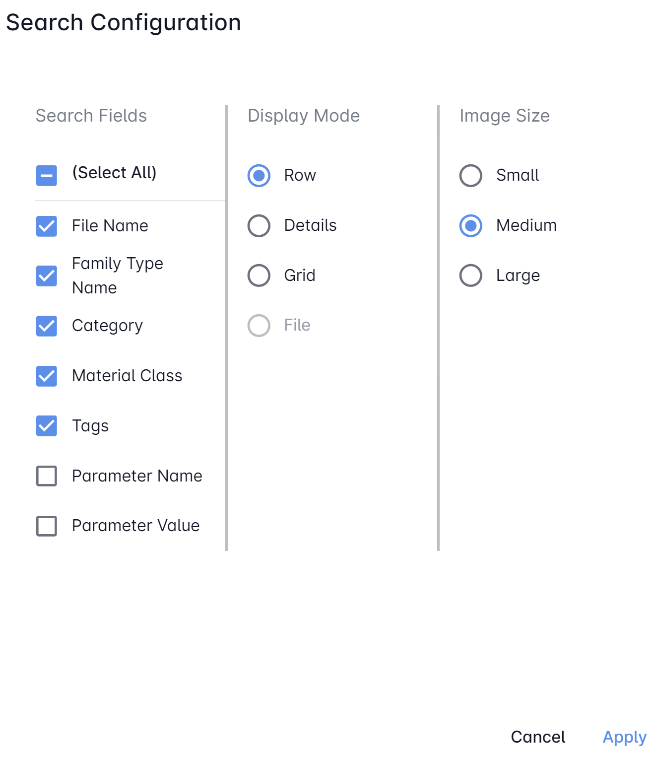

Now, you will be able to:
  • Select which fields you want to search in
  • Set the display mode
  • Set the image size
Standard Search

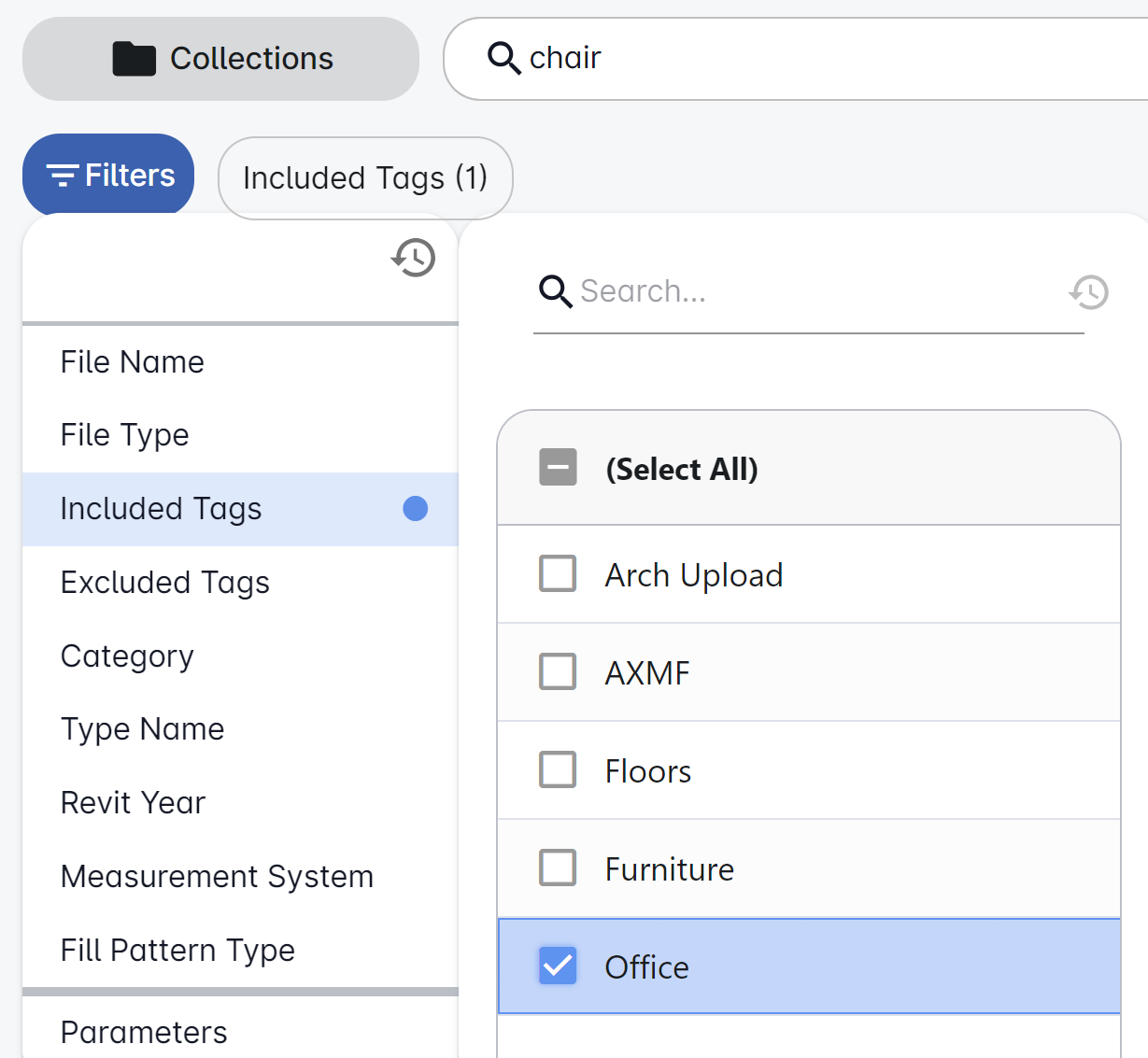

If you type a tag name along with your search term, Content Catalog will find content that matches both criteria. For example, you could search for “hospital bed,” and Content Catalog will find all beds under the “hospital” tag.
Additional filters
You can also select the Filters button below the search bar to customize your search even more.
Standard Search
Then select the filters that you’d like to search by.
Standard Search

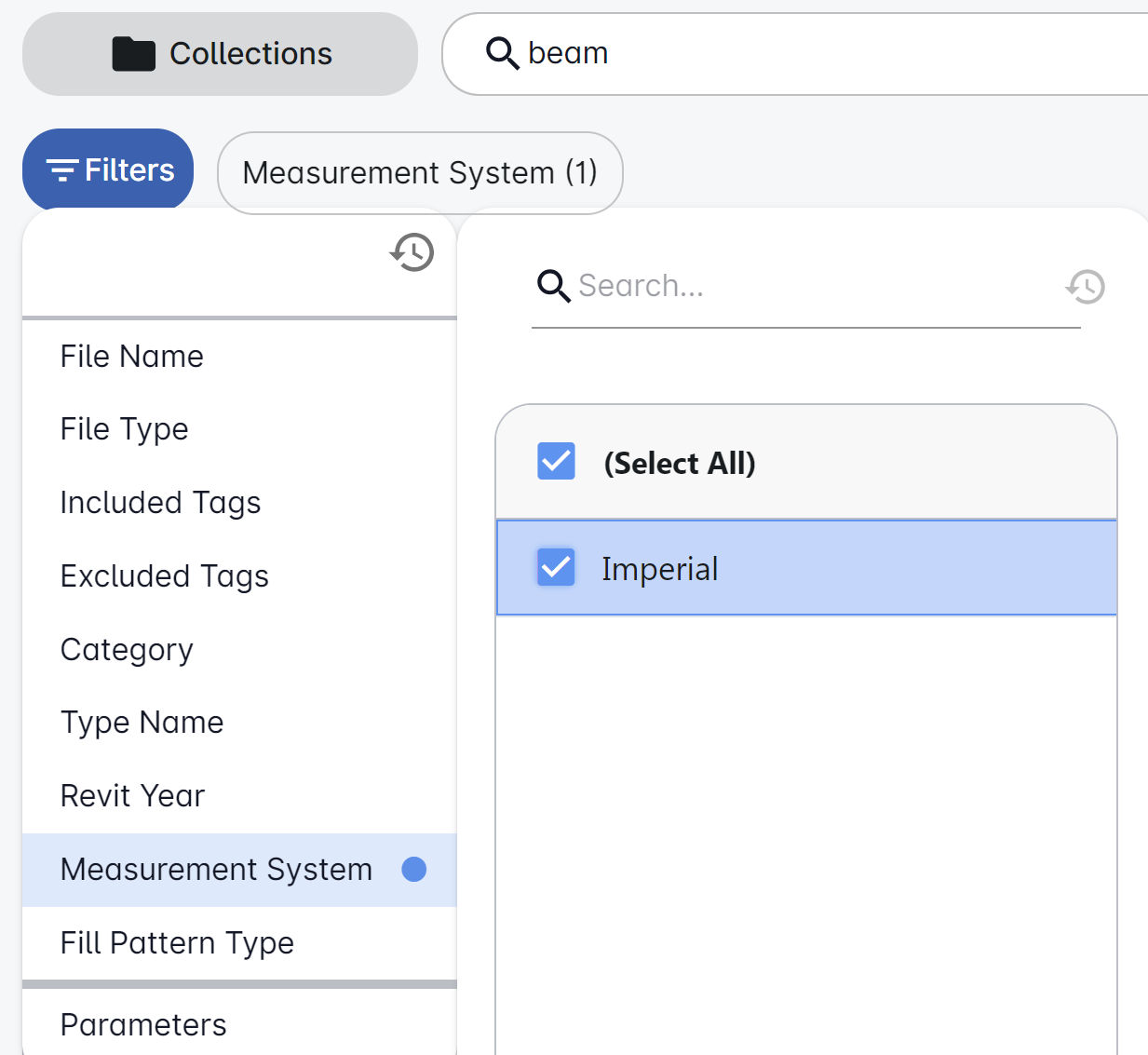

How to search for content with a particular measurement unit
To search for content with a particular measurement unit, you can use a filter.
Select Filter > Measurement System > Imperial or Metric.
Note: Mainly loadable Revit families have a Measurement System parameter

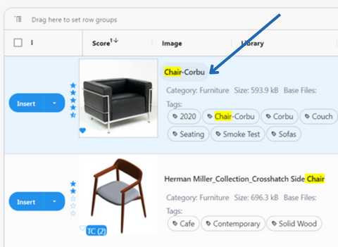

How to review search results
You can view star ratings, tags, which Collections it belongs to, and more. If you need more information on the family, you can click on the name to view more.
Standard Search

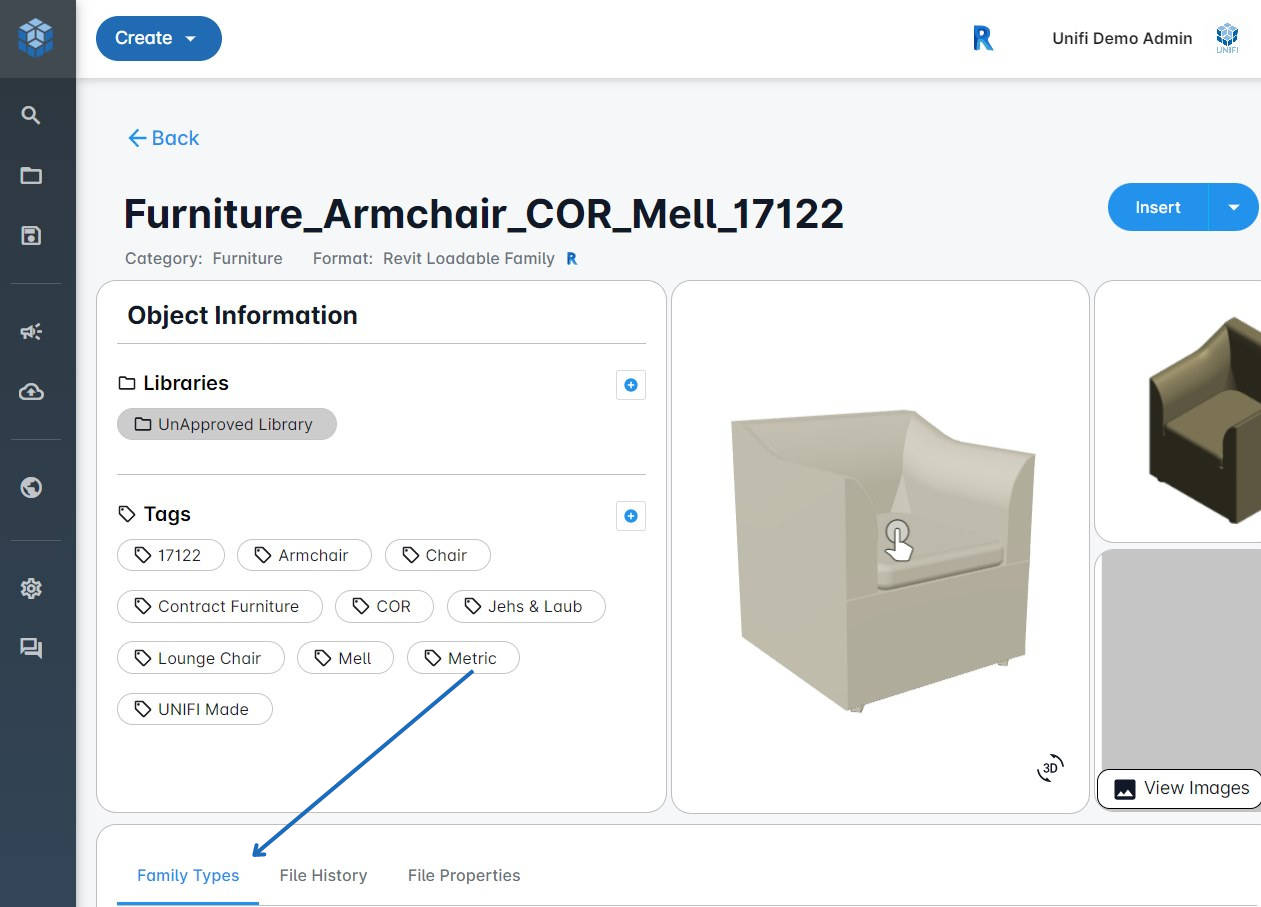

You can click on the tabs to view the different family types and their parameter data before bringing it into your project or even opening it in Revit.
Standard Search
Once you’ve confirmed that this is the family that you want in this project, you can click on the Insert button.
Standard Search
