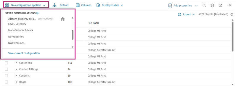

  2. Click Configurations.
    A drop-down list opens, displaying any previously saved configurations.
    • The Home icon indicates which configuration is the default for the project.
    • Last applied indicates which configuration was the most recently applied to the view. This is typically the configuration that is currently displayed.
      • A blue dot indicates that the current configuration in the view is different from the last configuration applied to the view.
    If there are no current configurations, or no configuration set as default, the data table is displayed using the standard system configuration.

  1. Open the view that you want to apply the configuration to.
  3. In the drop-down list, hover over the name of the configuration you want to apply.
  4. Click Apply.
Last applied is displayed against the name of the applied configuration.

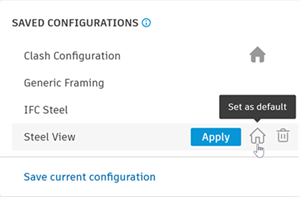

Set or change the default configuration
To set the default:
  1. Click Configurations.
  2. In the drop-down list, hover over the name of the configuration you want to set as the default.
  3. Click the Home icon.
  4. Click Confirm to set the default configuration.
The Home icon is displayed against the name of the default configuration.
