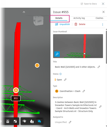

    You can respond to issues by accessing the Details tab in the issue panel, in either the issues log or the viewer:
    • Issues log: Click the relevant issue to review and edit entries in the Details tab directly in the Issues tool.
    • Viewer: Click the relevant issue in the Issues tool, and scroll to the Placement section of the Details tab. Click the file name to open the issue in the viewer, where you can see the full context of the models that were open when the issue was created.
  2. If you are using the viewer, use the viewer toolbar to take measurements and inspect model properties to help you understand the issue and how to resolve it.
    Note: All issues related to the models open in the viewer are displayed in the Issues tab , including issues not created in Model Coordination. If you select one of the issues not created in Model Coordination, the pushpin is shown in the viewer, but the models are not highlighted.
  3. Use the Details tab in the issue panel to review the issue details including any references and comments.

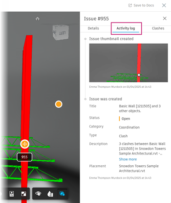

    You can also use the Activity log tab to view previous activity on the issue:

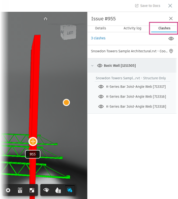

    When working with issues created from clashes or clash groups, or issues that are specified as Clash type issues, you can use the Clashes tab to see the name of the placement model (the model on which the issue pushpin was placed), and the number of clashes that are involved in the issue:
    You can click on each clash in the list to isolate them in the viewer, and use the icons to hide or show all or individual clashes.
    Note: The Clashes tab is only available when viewing clash issues in the Model Coordination viewer. It is not available from the Issues tool, or anywhere in Autodesk Docs or Build.

    • Use the Details tab in the issues panel to attach references such as photos, or add attachments to demonstrate the changes made or required.
    • Use the Details tab in the issues panel to add comments. The issue assignee can see all comments.
