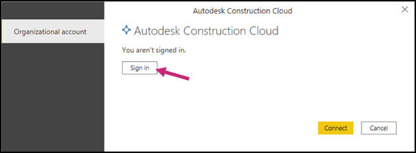

    You now need to sign in with your Autodesk credentials.
  10. Click Sign in.
  11. Sign in with your Autodesk credentials.
  12. Click Connect once you're signed in.

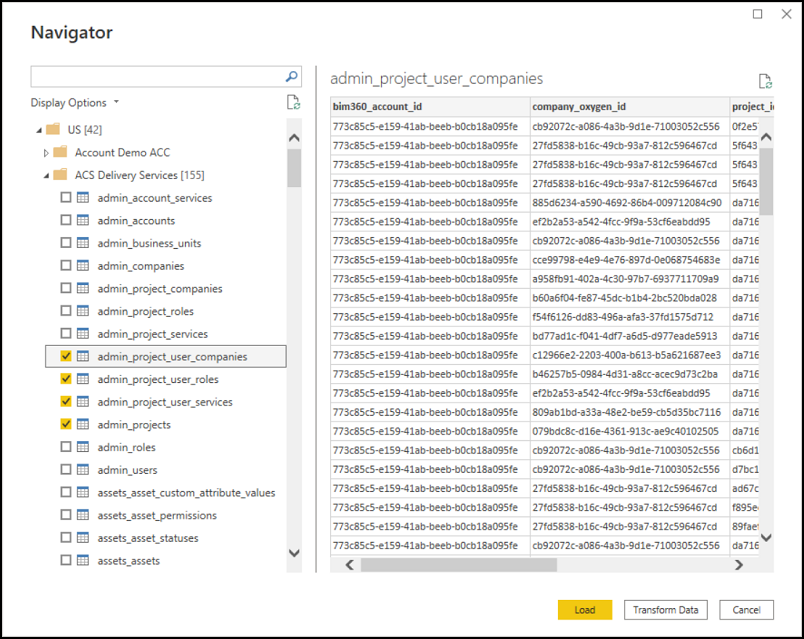

  13. In Navigator, expand the hub you want to pull data from, select the desired tables, and then either select Load to load the data or Transform Data to continue transforming the data in the Power Query editor.
