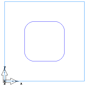

    This step defines the profile.
    1. Select Construct tab > Curves panel > Other Methods > Rectangle.
    2. In the Rectangle dialog:
      • Select Use corner, width, and height.
      • Enter corner point of 1, 1, 0.
      • Enter a corner radius of 0.5.
      • Enter a Width of 2.0.
      • Enter a Height of 2.0.
      • Click OK.
